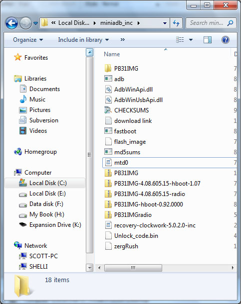

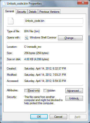

ok guys i finally have decided tonight to give this a shot. sorry for the very basic questions that will follow but i am very new to all this and for that matter any real c-prompt stuff.... i have just started to try and unlock the bootloader and im a little confused about how to get the unlock key.
i have gone to htcdev and got the email sent to me and now im on step 11 and having an issue. it says to save the unlock file to the same folder as
C:\Android --in my case it is--- miniadb_inc folder.
i save it to this folder which is on its own in my C drive but when i type in my c-prompt--- fastboot flash unlocktoken Unlock_code.bin ----
it says "cannot load unlock_code.bin"
not sure what im doing wrong but im sure its pretty simple but im to new to this to figure it out..lol
thanks for the help
thanks for the help
the directions assume that when you enter the command to unlock(fastboot flash unlocktoken Unlock_code.bin) that you still have your cmd window open,and the phone in fastboot.
off the top of my head,the only things i can think of are that the unlock_code.bin is not in your miniadb_inc directory,it has become corrupt during file trasfer or download,or possibly the phone is not in fsatboot. make sure that you are in fastboot,and not in hboot,or the booted OS.
you should also make sure that htc sync,pdanet,easy tether,or any other program capable of comunicating with the phone is disabled or uninstalled. you can try different usb ports or cables.
if its not one of those things,a copy/paste of your entire cmd window may provide some clues :)

c:\miniadb_inc>fastboot flash unlocktoken Unlock_code.bin
error: cannot load 'Unlock_code.bin'
hmmm,there is nothing immediately wrong with that... looks like it should have flashed fine.
when you saved it to miniadb_inc,did you change the name at all? if you did,its possible the name or file extention is changed somehow(for example,Unlock_code.bin.bin if you typed in the file ext)
the only other things i can think of,are if you were missing a character when you submitted the identifier token,or if you have something running on the PC thats interfering with it.
this is the unlock_code.bin that you got from the identifier token from this phone that youre unlocking,correct?
can you get a screen shot of the contents of miniadb_inc? you might also right clock on unlock_code.bin,click properties,and see what that says... make sure its still a .bin file
yes this is the unlock code for this phone. also i dont believe i have anything else running that would interfere with it. i do have htc sync but it is not active when i plug the phone in. i did not change the name of the bin file at all. i have attached some photos of the file.

with windows,you can use the Alt/Print Screen to take a screenshot of your active window,or just Print Screen to take the whole screen. this will copy a screen shot to your clipboard,then you can open photo shop or similar program, then open a new project(file/new) then edit/paste and it will open your screen shot. you can then save it,and hopefully upload.
alternately,you could adjust the camera on your phone to the smallest resolution,you could host the pics on photobucket,or upload them to somewhere like drop box.
you might just start the process over on a different pc or laptop that has never had any phone stuff installed on it.
