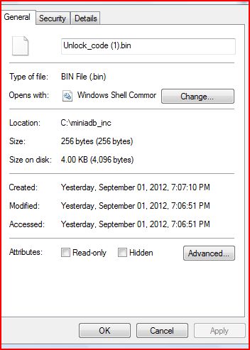

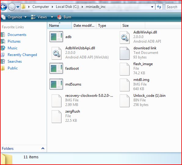

ok got the pictures figured out, thanks. here they are
ahhh the pic was a good idea,the prollem is now obvious. :smokingsomb:
you have apparently downloaded 2 unlock_code.bin files,at some point in time,as evidenced by the (1) in your file "Unlock_code(1).bin"
change the name in miniadb_inc to just "Unlock_code.bin" and it should flash fine. you were getting error: cannot load 'Unlock_code.bin becasue the file with that name wasnt there
wow thanks! that was it!!! not sure how that happened but i feel pretty stupid..lol
Don't feel stupid,that's definitely an easy thing to overlook,especially if you're not used to doing this sort of thing. I've made my share of mistakes,for sure. :eek:
I'm glad that fixed it for you. Holler if you have any other questions :)

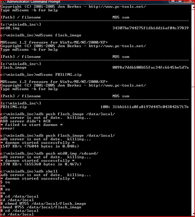

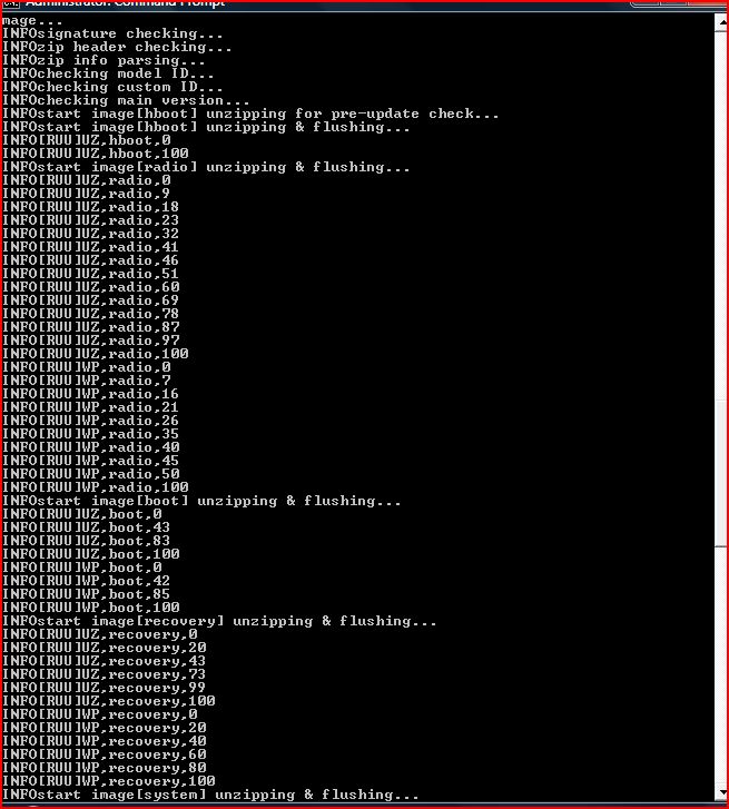

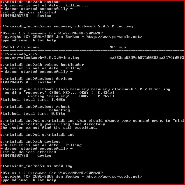

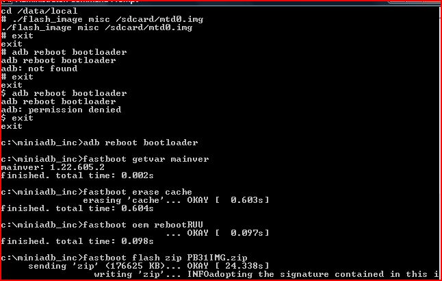

ok i started out early this morning but im now stuck on step 4.
i followed all instructions all the way to the end but when the last c=prompt command to fast reboot the phone reboots but gets hung up on the" droid eye" and then just keeps rebooting and rebooting?? i cant get the phone to do anything else? looks like my phone is now useless...
i hope its ok that i have attached pics of my c-prompt command window for you to take a look at.. as always thanks for your time! all pics are in order, just couldnt figure out how to make it one big picture..lol

this is what is in the command window if it helps to not dispay it as an actual pictue.
c:\miniadb_inc>adb devices
adb server is out of date. killing...
* daemon started successfully *
List of devices attached
HT04PHJ03730 device
c:\miniadb_inc>md5sums recovery-clockwork-5.0.2.0-inc.img
MD5sums 1.2 freeware for Win9x/ME/NT/2000/XP+
Copyright (C) 2001-2005 Jem Berkes - http://www.pc-tools.net/
Type md5sums -h for help
[Path] / filename MD5 sum
[c:\miniadb_inc\]
recovery-clockwork-5.0.2.0-inc.img ea382ca5809cb872d0582aa22741d592
c:\miniadb_inc>adb reboot bootloader
c:\miniadb_inc>fastboot devices
HT04PHJ03730 fastboot
c:\miniadb_inc>fastboot flash recovery recovery-clockwork-5.0.2.0-inc.img
sending 'recovery' (3064 KB)... OKAY [ 0.434s]
writing 'recovery'... OKAY [ 0.969s]
finished. total time: 1.405s
c:\miniadb_inc>fastboot reboot
rebooting...
finished. total time: 0.096s
c:\miniadb_inc>cd c:\miniadb_inc this should change your command promt to "mini
db_inc",indicating youre using that directory.
The system cannot find the path specified.
HT04PHJ03730 device
c:\miniadb_inc>md5sums mtd0.img
[c:\miniadb_inc\]
mtd0.img 34307be744275f1db1dd16af04c37839
c:\miniadb_inc>md5sums flash_image
[c:\miniadb_inc\]
flash_image 0098a7dd6600b55fac34fc6645be5d7a
c:\miniadb_inc>md5sums PB31IMG.zip
[c:\miniadb_inc\]
PB31IMG.zip 100% 31bb1611a0fa8197d447c0438426717e
c:\miniadb_inc>adb push flash_image /data/local/
ADB server didn't ACK
* failed to start daemon *
error:
1547 KB/s (76044 bytes in 0.048s)
c:\miniadb_inc>adb push mtd0.img /sdcard/
1370 KB/s (655360 bytes in 0.467s)
c:\miniadb_inc>adb shell
$ su
su
# su
su
# cd /data/local
cd /data/local
# chmod 0755 /data/local/flash_image
# cd /data/local
cd /data/local
# ./flash_image misc /sdcard/mtd0.img
# exit
exit
# adb reboot bootloader
adb: not found
# exit
exit
$ adb reboot bootloader
adb: permission denied
$ exit
exit
c:\miniadb_inc>fastboot getvar mainver
mainver: 1.22.605.2
finished. total time: 0.002s
c:\miniadb_inc>fastboot erase cache
erasing 'cache'... OKAY [ 0.603s]
finished. total time: 0.604s
c:\miniadb_inc>fastboot oem rebootRUU
... OKAY [ 0.097s]
finished. total time: 0.098s
c:\miniadb_inc>fastboot flash zip PB31IMG.zip
sending 'zip' (176625 KB)... OKAY [ 24.338s]
writing 'zip'... INFOadopting the signature contained in this
mage...
INFOsignature checking...
INFOzip header checking...
INFOzip info parsing...
INFOchecking model ID...
INFOchecking custom ID...
INFOchecking main version...
INFOstart image[hboot] unzipping for pre-update check...
INFOstart image[hboot] unzipping & flushing...
INFO[RUU]UZ,hboot,0
INFO[RUU]UZ,hboot,100
INFOstart image[radio] unzipping & flushing...
INFO[RUU]UZ,radio,0
INFO[RUU]UZ,radio,9
INFO[RUU]UZ,radio,18
INFO[RUU]UZ,radio,23
INFO[RUU]UZ,radio,32
INFO[RUU]UZ,radio,41
INFO[RUU]UZ,radio,46
INFO[RUU]UZ,radio,51
INFO[RUU]UZ,radio,60
INFO[RUU]UZ,radio,69
INFO[RUU]UZ,radio,78
INFO[RUU]UZ,radio,87
INFO[RUU]UZ,radio,97
INFO[RUU]UZ,radio,100
INFO[RUU]WP,radio,0
INFO[RUU]WP,radio,7
INFO[RUU]WP,radio,16
INFO[RUU]WP,radio,21
INFO[RUU]WP,radio,26
INFO[RUU]WP,radio,35
INFO[RUU]WP,radio,40
INFO[RUU]WP,radio,45
INFO[RUU]WP,radio,50
INFO[RUU]WP,radio,100
INFOstart image[boot] unzipping & flushing...
INFO[RUU]UZ,boot,0
INFO[RUU]UZ,boot,43
INFO[RUU]UZ,boot,83
INFO[RUU]UZ,boot,100
INFO[RUU]WP,boot,0
INFO[RUU]WP,boot,42
INFO[RUU]WP,boot,85
INFO[RUU]WP,boot,100
INFOstart image[recovery] unzipping & flushing...
INFO[RUU]UZ,recovery,0
INFO[RUU]UZ,recovery,20
INFO[RUU]UZ,recovery,43
INFO[RUU]UZ,recovery,73
INFO[RUU]UZ,recovery,99
INFO[RUU]UZ,recovery,100
INFO[RUU]WP,recovery,0
INFO[RUU]WP,recovery,20
INFO[RUU]WP,recovery,40
INFO[RUU]WP,recovery,60
INFO[RUU]WP,recovery,80
INFO[RUU]WP,recovery,100
INFOstart image[system] unzipping & flushing...
INFO[RUU]UZ,system,0
INFO[RUU]UZ,system,6
INFO[RUU]UZ,system,12
INFO[RUU]UZ,system,19
INFO[RUU]UZ,system,25
INFO[RUU]UZ,system,32
INFO[RUU]UZ,system,39
INFO[RUU]UZ,system,45
INFO[RUU]UZ,system,51
INFO[RUU]UZ,system,58
INFO[RUU]UZ,system,64
INFO[RUU]UZ,system,71
INFO[RUU]UZ,system,78
INFO[RUU]UZ,system,84
INFO[RUU]UZ,system,89
INFO[RUU]WP,system,0
INFO[RUU]WP,system,89
INFO[RUU]UZ,system,90
INFO[RUU]UZ,system,91
INFO[RUU]UZ,system,92
INFO[RUU]UZ,system,93
INFO[RUU]UZ,system,94
INFO[RUU]UZ,system,96
INFO[RUU]UZ,system,97
INFO[RUU]UZ,system,98
INFO[RUU]UZ,system,99
INFO[RUU]UZ,system,100
INFO[RUU]WP,system,90
INFO[RUU]WP,system,91
INFO[RUU]WP,system,92
INFO[RUU]WP,system,93
INFO[RUU]WP,system,94
