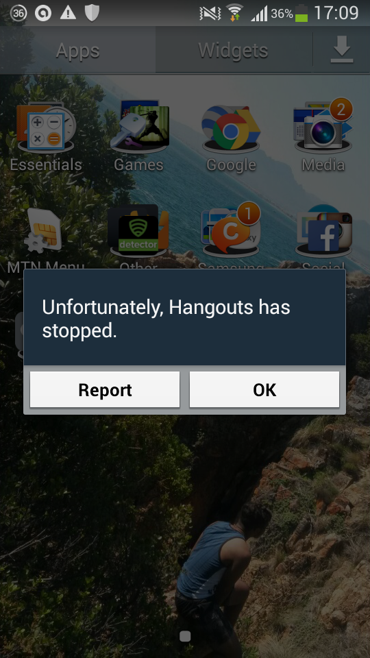

I realize that this is an old post, but I also have the same problem. I deleted google service framework and also tried everything @Hherrmmann did. My phone is rooted though, so it isn't disabled. Please help! I can't use any google apps, especially Hangouts and Playstore. In the picture is the description they give me when I want to use these already mention apps.
If it's messed up like that, surest way is to re-flash the original manufacturer's firmware, and that should put it back to a correctly working state, and undo any damage.
