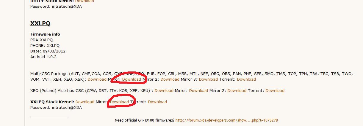

Ok, so I think I figured this out, but I want to make sure before I upgrade to ics. So I followed your directions on the first page of this post to root my phone. I think its running KG2. I'm not to familiar with all these terms yet.
Now I downloaded the two links from the XXLPQ link you posted.
So do I add the first file in Odin in the pda spot or the kernal file or do I use both somehow?
Thanks in advance.
You don't need the kernel. It is included in the rom. The link is there because some people flash back the kernel after rooting.
To flash the rom please follow the method shown on my front page.
You will need to unrar the file which should leave you with a tar file in the folder. Use PDA to flash this. Be careful to only check what is show on my guide images.
