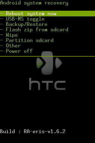

Here are the results
C:\sdk\platform-tools>fastboot boot recovery-RA-eris-v1.6.2-trackball-optional.img
downloading 'boot.img' ... OKAY
booting... OKAY
The Phone vibrated and now it has this!
Thank you again!

huntdilan,
Sounds like your pretty close to being all the way back!
Just to be clear, you actually see "[trackball optional]" at the bottom of the custom recovery screen, right?
I just want to make sure that you've really got the tweaked recovery for if (when? ;)) your trackball might goes south on you...
I'll let the other guys finish-up their fine work with you. You've been a very good student, by the way :).
Kudos and props again to Scotty, doogald, and especially for erisuser1 for all his mind-blowing work that he's done for everyone re. our little Erii.

huntdilan,
Cheers!
Oh yes, I am almost there!
Yes, I see the ""[trackball optional]" at the bottom of the custom recovery screen.
Thank you!

Well, I didn't do another fastboot flash after I successfully installed the ErisMTDNuke_v0.9.zip.
I powered off the the phone, the held VolDn and it booted in HBOOT. I pressed the VolUp and when into Recovery and installed
the GSBv3.5-ODEX-cm-7.1.0-RC0-Eris-signed.
The trackball works fine and other keys under Android Recovery System are okay!

Is it still behaving that way after you flashed the "ErisMTDNuke_v0.9.zip" fix?
No, it didn't! It stayed into the Android Recovery System
