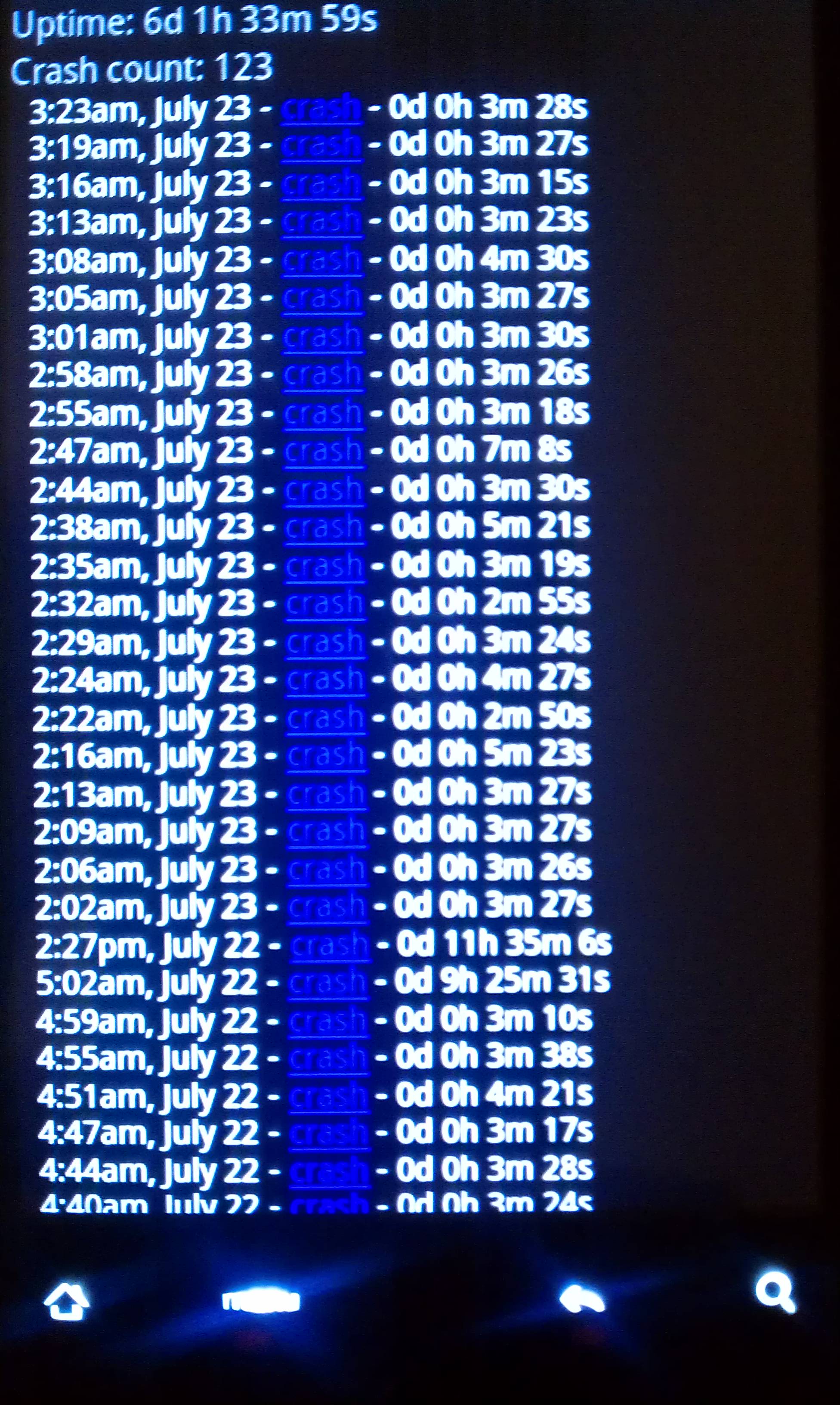

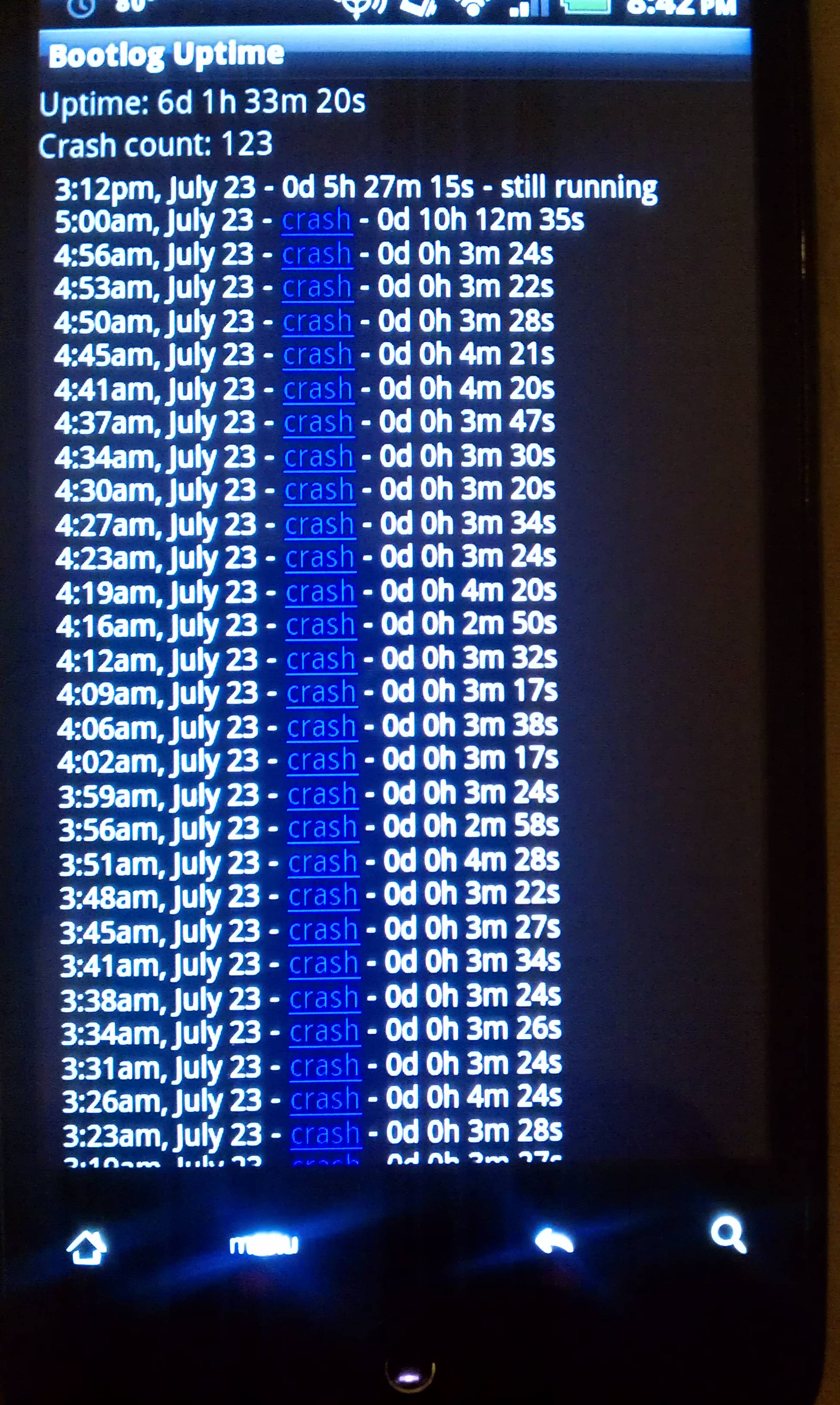

Sounds like I'm not the only one with this problem. See attached!!
