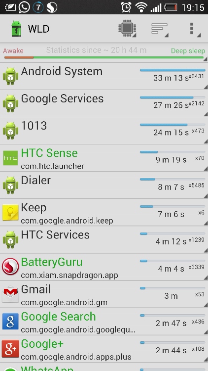

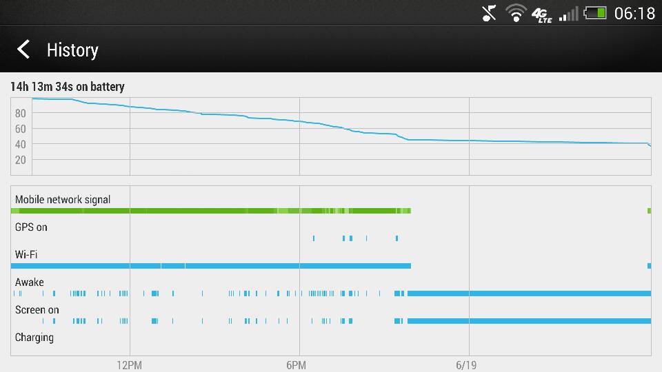

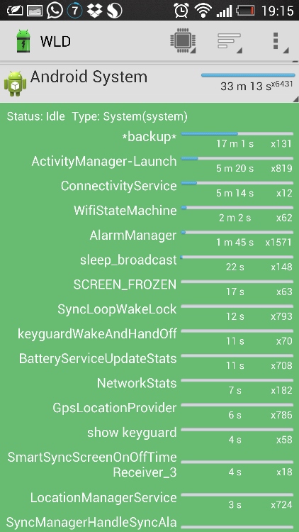

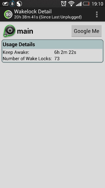

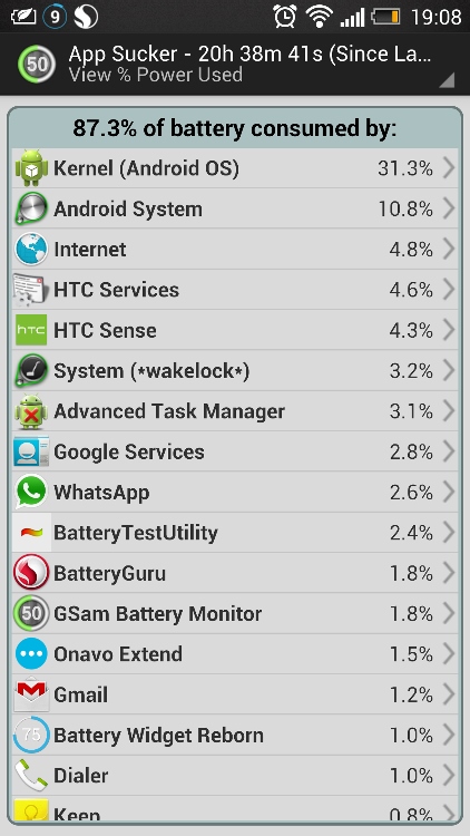

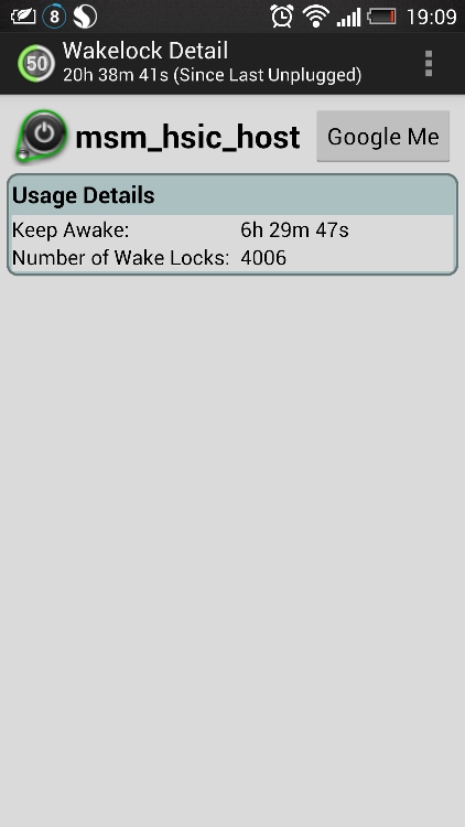

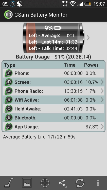

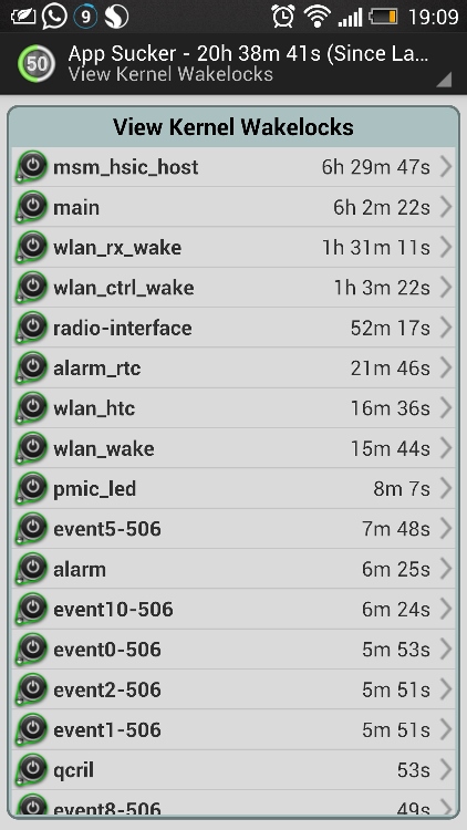

Hey guys,
So I got the HTC One Unlocked 32GB Silver edition from HTC USA roughly a month ago, been using it abroad in Africa and this phone is hands down the best phone I have ever used. I upgraded from a Galaxy Nexus which I loved but in the end the abysmal battery life forced me to give it up and mixed reviews of the Nexus 4 battery life made me eschew that phone in favour of the One.
Battery life has been decent so far but after the latest OTA update by HTC, my standby drain has become worse, I basically lose 1% every 15-25 mins which means that I am always running low by 1800h/1900h and once the battery hits 20% it drains pretty fast from that point on wards. I am on stock ROM unrooted, screen on auto brightness, Google Now turned off.
From the stats I have from GSam & BetterBatteryStats, it's two wakelocks that are particularly insanely active - "msm_hsic_host" with over 4,000 wake locks & "main". By the way about 7 hours of the total cycle time is attributable to airplane mode which I activate from 2330h to 0630h.
I have a feeling rebooting the phone would not work, would anyone have an idea on how to rectify this or would it only be possible by rooting and flashing custom ROMs &/or kernels (of which I have no experience whatsoever!)
Thanks!

Hey guys,
Thanks!

Hey guys,
Thanks!
I could be wrong,but,according to the 1st & 2nd screenshots,WAKELOCKS are accounting for a small % of battery usage (0-3%).
Screen-on time/brightness & strength of data signal/GPS/WI-FI are typically the biggest consumers of battery power.A weak signal will suck down a car battery,much less your phone.
As Tlicious1020 referred to,these are probably the areas that need to be addressed/ruled out.
Setting aside all the other stats for a moment,what is your typical run time before having to re-charge,say with 5-10% of the battery remaining?
mpanju -
The Nexus 4 battery issues also traced to the msm_hsic_host wakelocks. Last I heard they believed that it was a kernel issue at some point.
MSM is the part number prefix for the Qualcomm modem, the rest of the name for that wakelock is specifying an interface or function class most likely.
The modem chip sits between your main processor and the radio transceiver hardware.
The problem can stem from bad reception as noted in the posts above, bad control software (last year's Nexus 4 kernel), or simply a stuck bit in silicon somewhere.
Please hold down power for ten seconds until the phone recycles. Unlike a reboot, that will force all the silicon to a known state.
If the issue is a stuck bit messing up control, that would clear the problem.
Look at the Gsam graph, check the box to show your radio reception. If you're fighting a low or wildly fluctuating signal, that would be the problem.
When those are eliminated and problems from other users with the same software revision as yourself confirm the same observations, then it may be time to contact HTC.
Rooting is the same thing as getting admin access on your pc, it allows you to change system software. In this case, you could conceivably go back to your previous revision or install some fix, if it occurs before HTC does it, and assuming that's the problem.
But please try to check out the first two things mentioned above, they're the more likely suspects, and ought to be eliminated first.

Firstly, thanks for all the prompt feedback guys, it is truly appreciated and it's folks like you who make the Android community so awesome!
Tlicious1020 - I did try turning off the auto brightness a couple of weeks ago but I don't like dimming the screen too much and I had set it at 50% for 2 days to test it out but I found that when using the phone, the battery life depletion was more than having auto brightness enabled. I also maintain power saver mode all the time (unchecking the brightness option though)
EarlyMon - Thanks for tips, I noticed that a lot of the search results relating to the msm_hsic wake lock were of the Nexus 4. I did the 10 second power button reboot and I'll see how that goes. At my residence, I am always on Wi-Fi but I suppose that my work location could be a reason for poor signal, I do not have Wi-Fi there. I'll pay more attention to the GSam graph for battery against phone signal and also check the stats for phone signal. But wouldn't you say that the wake lock time for "main" at over 6 hours is not normal? I am using all the home screen panels and BlinkFeed, I have Google Keep and a Weather widget running, is that why "main" is so active?
Kolio - I usually end up with 10% at around 1800h or 1900h depending on how much I use the phone. I have tried scaling back a bit but as I said the drain seems to be constant but I always manage around 2.5 - 3.5 hours of screen on time before it hits 5%. I try not to leave the phone charging overnight but I do end up doing that occasionally when I get home late. So the charge time is either overnight from 2300h/0000h or from 20000h to 2300h and I have auto enabled Night Mode in Battery Widget Reborn from 2330h to 0630h.
