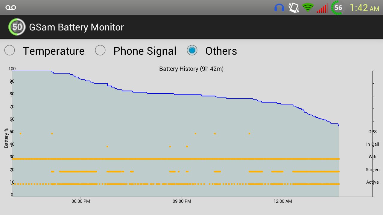

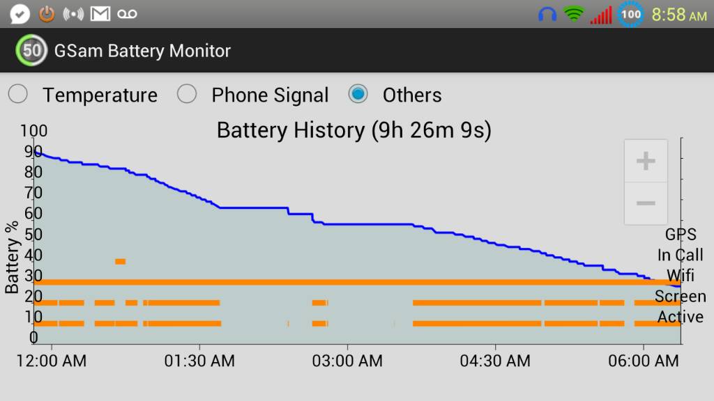

The first attached graph shows a very well-behaved phone with respect to apps and being awake. **Most feeds are off.**
Note that when the screen is off the phone is not active, other than occasional blips - that's likely my email syncing. If I zoom in more a few more insignificant blips show it awake a little more, but nothing to be concerned about.
The second graph shows the same thing but with something waking the phone constantly. In extreme cases, the awake time degrades the battery curve badly and that's when you need to care.

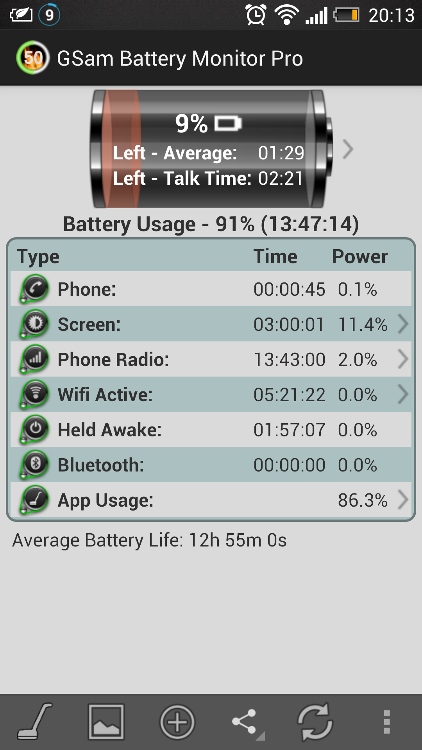

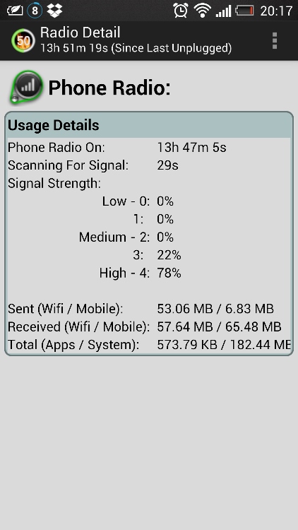

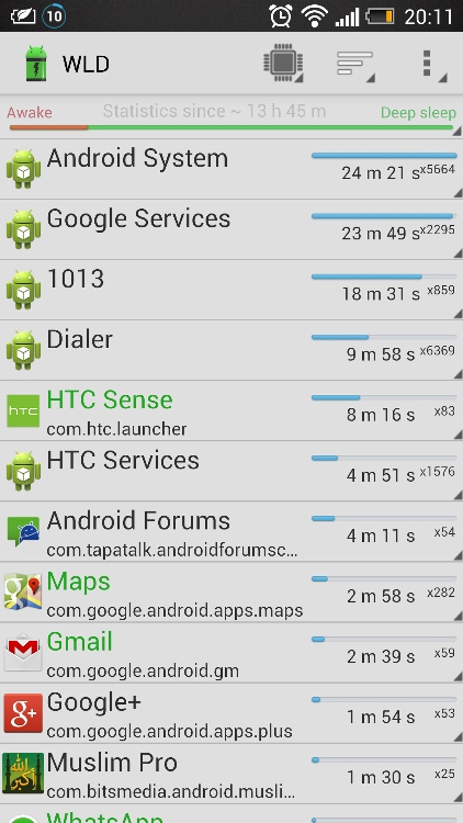

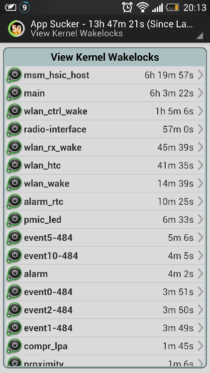

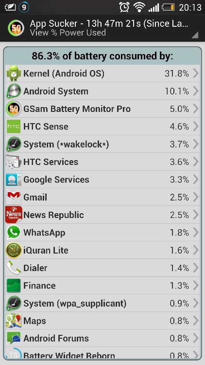

EarlyMon, Tlicious1020, Kolio (and all forum members!),

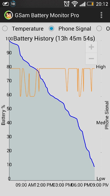

I've attached my battery life screens for my usage today. The usage is fairly light in comparison, I did not use it too much in the morning on the way to work as I normally do, I only clocked in around 30 mins screen on by 0900h (I pulled it off the charger at 0630h). As I was quite swamped at work I barely got a chance to touch the One (Yet it still depleted to 60% by 1400h!) and I only managed to get going when leaving work at around 1815h. Judging from the stats I'd pretty much rule out poor signal as the cause of my standby drain, the signal was for the most part good (as evidenced by the attached screen showing signal strength). So it definitely seems to be a kernel issue (and that horrid msm_hsic wake lock!)
I am going to go ahead with a factory reset but I don't expect it to resolve the issue. One thing is for sure now, there is no way I'd be able to get more than 24 hours out of this handset regardless of my usage, I think the One has pretty damn good battery life but my unit's standby seepage really degrades what would have been a truly all day lasting handset. As I have no experience or knowledge about rooting & modding phones I might as well just hope that the 4.2.2 update improves my standby time.

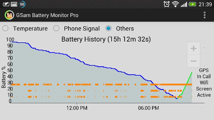

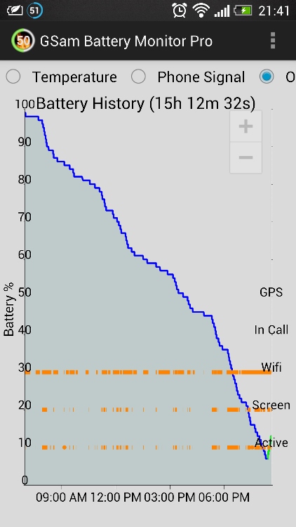

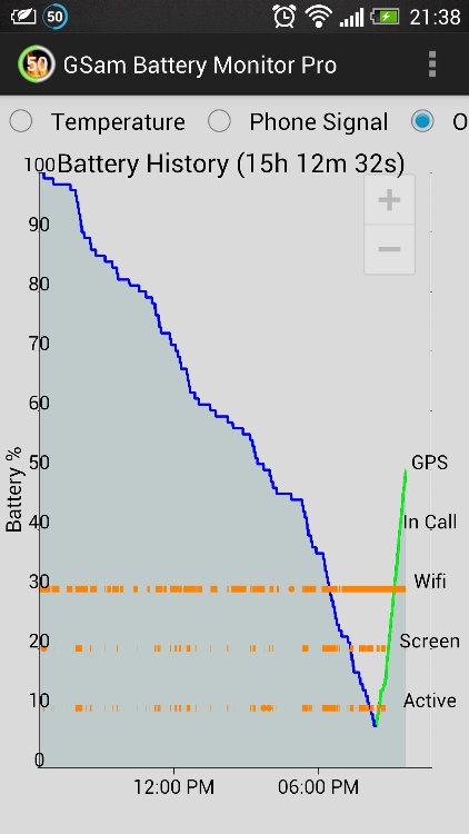

EarlyMon,
Sure I can, only thing is that I put the One on charge right after I posted earlier, I hope these are OK.

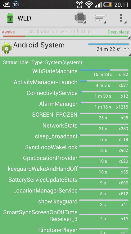

Mpanju -
No, those are good. :)
Seems that you don't have much time where the screen is off but your phone is awake.

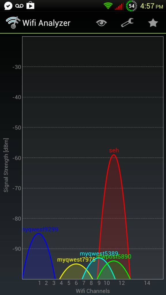

What's up with the wifi signal? Are you in one location? Why is that cycling on/off?
If you're in one location, and no reason for that, please get Wifi Analyzer, also free. Is the network on a crowded channel? Is the net name a router default being shared with other networks??
Mpanju -
EarlyMon,
The location where my desk is picks up the faint WiFi from an adjacent area, the Wi-Fi is locked and so not many people are on it (Speeds are quite slow here, don't know if that makes a difference) but I end up using data when in the office. I do move around a bit, from 1130h - 1400h I was in offices that do not have Wi-Fi and as you will notice, I did not touch my phone much between 0900h and 1300h.
Even when I am at home, and I am the only user on my WiFi network, I still get a drain of 5-10% per hour on standby!
By the way, which version of WiFi analyzer do you recommend, there are quite a few in the Play Store?

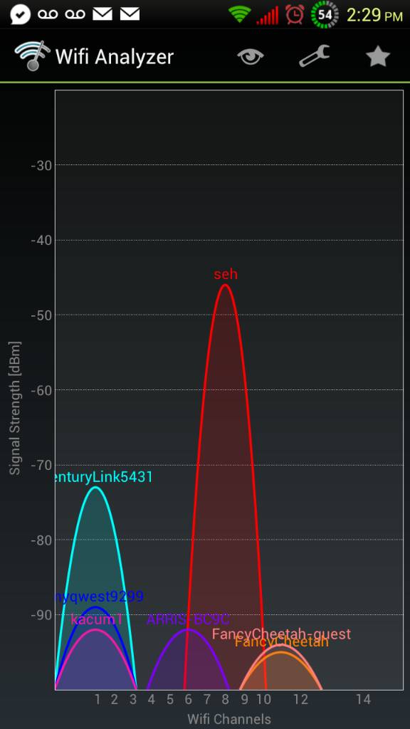

Check out "Wifi Analyzer"
https://play.google.com/store/apps/details?id=com.farproc.wifi.analyzer
Sweep left / right for various screens.
Following shots show me, seh, on a crowded channel and a free one. Note the signal improvement.
If I had to make a prediction - either coincident to your last update, or due to a network improvement in your last update that routers you're hitting don't like, that's what changed your battery response and is the root cause of your trouble.
