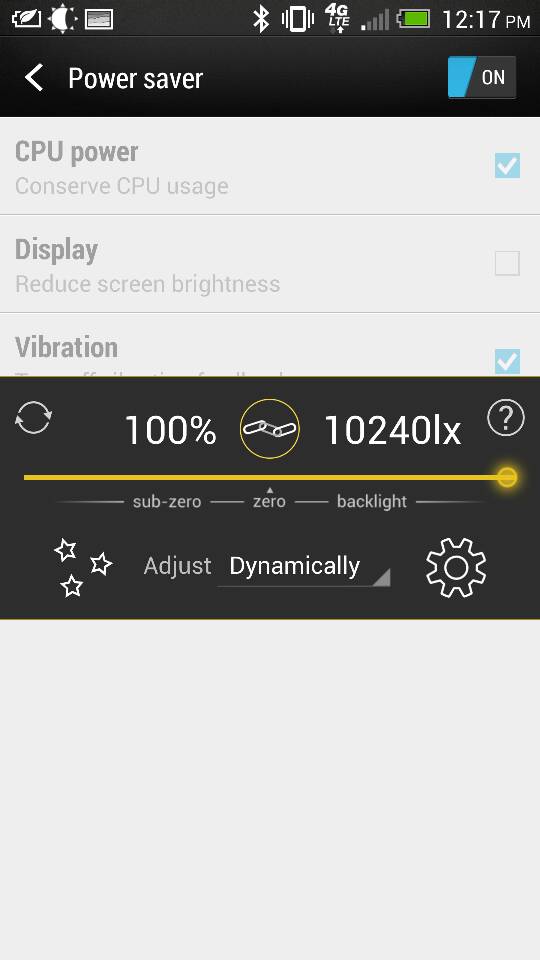

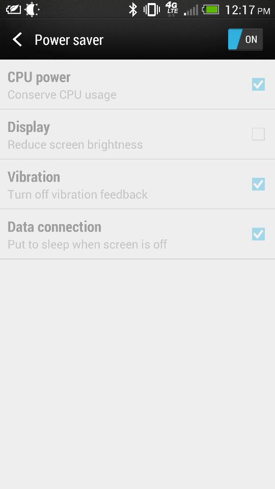

I don't know if anyone has said this. I bought Lux. See my images. I still use the power saving but I use lux for the brightness. That seems to yield me about 10 hours on a normal day.
