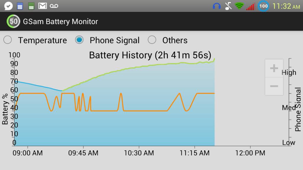

thanks again which one is the phone signal graph?
There's some indication in the plot you posted (how dark the green bar is), but if you select the graph in GSam there's an option to plot battery history overlaid with phone signal strength (the default is overlaid with battery temperature, but there's a selector at the top of the graph).
sorry to be a bit slow i cant seem to find that graph on the app
GSam, graph icon second from the left at the bottom, then the phone signal button at the top as Hadron said.
Top of your graph says History - that looks like the HTC graph rather than the top of the GSam one.

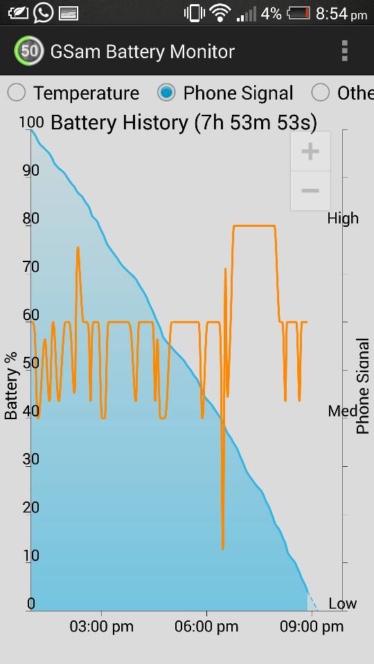

This is from yesterday. I also noticed sometimes when I take my phone off charge from 100% it drops straight to 94% within 1 minute. I only noticed this problem after updating to 4.3
It's been there all along, please see charging info at - http://androidforums.com/showthread.php?p=6250954
Please look over the previous posts on graphs from the last few days, let's see if your phone is staying active with the screen off and what your signal is like.

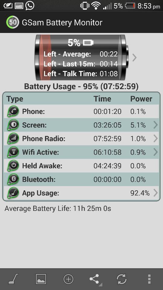

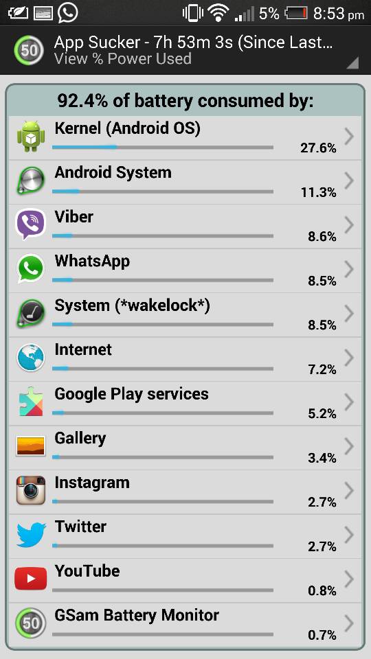

can i ask because i know nothing about wakelocks but does this seem abnormal to you when i only used fb once today
Normal no.
Normal for Facebook, yes.
They've enjoyed a history of putting out the worst mobile apps in every way imaginable for the +3 years I've paid attention to them.
The HTC integration actually helps.
Maybe check the Play Store, search Facebook. From time to time someone will come out with an app for a while that does their stuff properly.
Sorry, it is what it is.

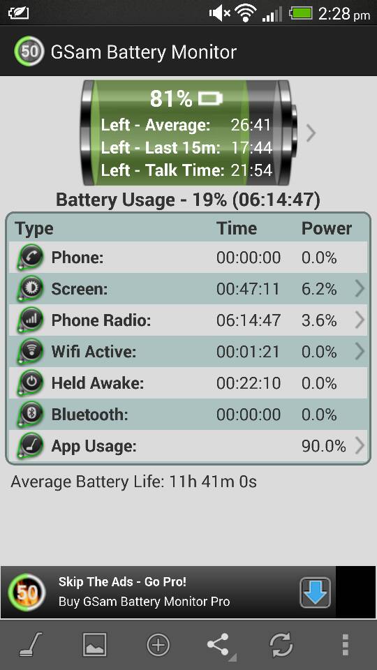

do i have a bad battery? this happens all the time, im at 50% or below and all of a sudden the phone shuts down. then when i charge it, it shows the battery is fully drained?!?!? here's a screen shot..
Is this normal battery life?
Travelling has a big impact on Battery life and I find it helps to switch data off when I do, It stops the phone from constantly having to search for a cell.

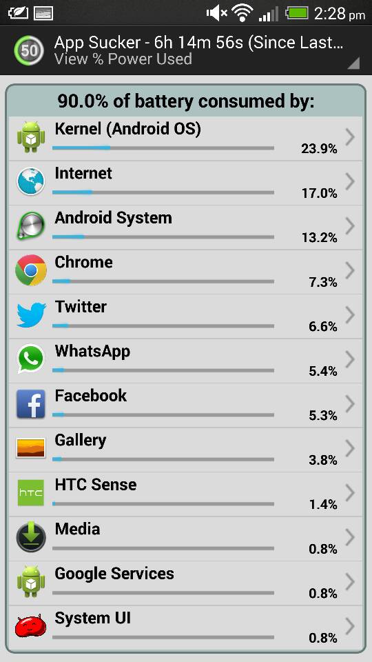

I'm noticing some battery issues lately, some things are keeping my phone awake, but I'm not sure how to correct it. Here's a pic I took today.
