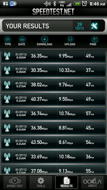

Here's the speedtest from this morning. The morning time is usually the best in this area... and I have multiple new records even without trying hard! In the past (with old firmware) they were typically 20 to 32 Mbps and almost 35 at one time. Today's run with the new firmware (same time/hour of the day) ranges from 30 to 43.50 Mbps. (Happy!). bye.
(edit: all tests/numbers are from indoors; not outdoors)
