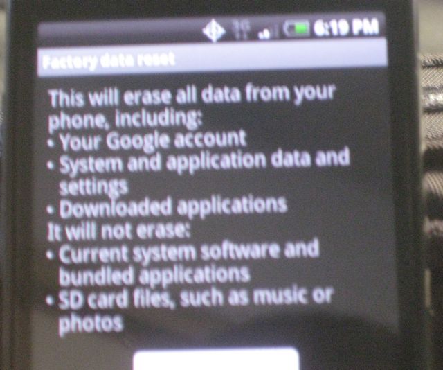

When wiping post 2.2 install, do we want to do 'Format Phone Storage' or 'Factory Data Reset'?
Thanks.
Since the update is a firmware/software update would factory reset just give you a clean slate of 2.2 and not bring you back in time to 2.1?
I'm just being paranoid now......:eek:
You are correct.
Attached is factory reset screen from 2.1. it says "Current system software" If you do this after the update you're good to go.
