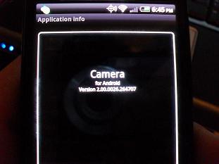

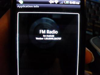

Okay, so I ordered a phone off of ebay, and am still waiting for a response from the seller as it is the weekend. My problem is the camcorder locks up, and I have no idea if the phone is rooted and if so not even what rom and such. I did some scoping on these forums and found alot abut this issue, but I am not accustomed to working with android and need some help learning how to fix this. Attached are some photos of my os version as well as camera and radio app versions, anything you guys could tell me would be a great help.

Your device is running the eclair radio with the 2.2 software so that's why your camcorder is broken. Check for the app "Superuser" in your app drawer to see if you are rooted. If it's there, try loading up a root app like Drocap (screenshot app) to see if it works. It's possible, they upgraded the OS via an update.zip file unrooted to get the phone to it's current state.
I'm not sure how it's been set up to work on Boost Mobile but your options to get the camcorder working are to load the 2.2 RUU like sdrawkcab mentioned or you can flash just a newer radio (PB31IMG file on the SD card from hboot). This would require your card to be formatted to FAT32.
Flashing the entire system IMG in a similar fashion, or running the RUU will lose root (if you even have it) and will reset everthing back to stock configuration so I'm assuming you'd lose the Boost Mobile hack...I'm calling it a hack b/c I'm unfamiliar with it and figure something must have been modified to make it work with what would seem to be a Verizon chipset?
So unless you can figure out the hack's origin, I'd be careful doing much to it before making a nand backup. Get that under your belt so if anything goes south, you can at least get back to where you are now. Then, I would probably recommend upgrading the radio after that. The most widely used Froyo radio is the 7.28. That will fix the camcorder and I believe Bluetooth will be in the same boat if you use it.

lolz, internal memory. Well not to my surprise I beat oneworldcellphone to the punch and flashed my own radio image. Only been about ten minutes since I did it, but I tested it and it appears to run really good. It was laggy at first but after a few seconds (probably to load) it was smooth and in HD like it should be.
Big thanks to iowabowtech for getting the ball rolling, and another thanks to sdrawkcab25 for the link and help formatting!
