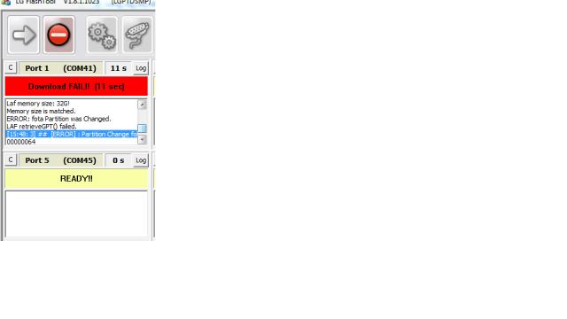

By using flash tool 2014 I somehow able to communicate with the cellphone but when I want to push a .TOT file it give me an error message like:
Error: fota partition was changed
LAF retrieve GTP failed
Partition Change fota
Any idea?
this is like Lg FlashTool looks like once I flash the .TOT file (it only accept the TOT file not the KDZ)
To me it seems it can recognyze my phone (IMEI it s correct) ...

sorry .. here you go

Hi, So i carried out the method that you had suggested and this is the error I am getting. PLease help me out.
same error as mine.
