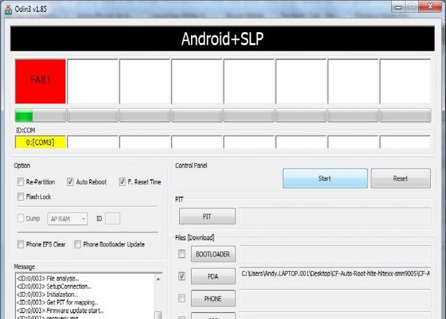

Once I started the root process, it failed almost straight away.

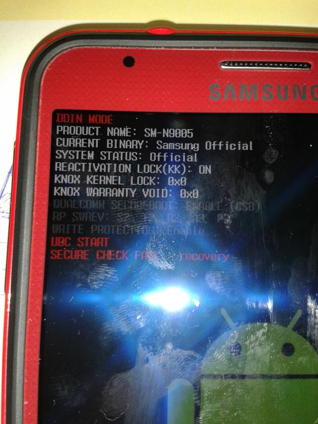

The message displayed on my phone can be seen in the attached image.
I mentioned this to a mate at work who recently rooting his S3. He said check that the version of Odin is the last 3.09. The one that I was using, and was downloaded from Dynomot's guide was version 1.85.
So proceeded to try rooting through this later version. Again it failed.
The text box in Odin displayed the below
<ID:0/003> Added!!
<OSM> Enter CS for MD5..
<OSM> Check MD5.. Do not unplug the cable..
<OSM> Please wait..
<OSM> CF-Auto-Root-hlte-hltexx-smn9005.tar.md5 is valid.
<OSM> Checking MD5 finished Sucessfully..
<OSM> Leave CS..
<ID:0/003> Odin v.3 engine (ID:3)..
<ID:0/003> File analysis..
<ID:0/003> SetupConnection..
<ID:0/003> Initialzation..
<ID:0/003> Get PIT for mapping..
<ID:0/003> Firmware update start..
<ID:0/003> SingleDownload.
<ID:0/003> recovery.img
<ID:0/003> NAND Write Start!!
<ID:0/003> FAIL! (Auth)
<ID:0/003>
<ID:0/003> Complete(Write) operation failed.
<OSM> All threads completed. (succeed 0 / failed 1)

Okay just gone back to Odin 1.85 as advised in your guide. Made sure I followed the guide to the letter, and still nothing.
Failed at exactly the same point.
Going to uninstall Kies, and re-install. Wonder if there's an issue with the USB drivers. Some ports on this laptop can be temperamental.
Okay even more baffled now.
I realized I updated Kies when it prompted me to. So I uninstalled, and did a clean install of both Kies, and the USB drivers.
Ran Odin 1.85, and used another USB port on my laptop. After it installed some other Samsung USB drivers, Odin saw my phone no problem.
Went on to flash the Rooting file. Only for it to fail again. At EXACTLY the same point.
Personally I think its something to do with the communication between my Odin, and my phone. Though I cant think what else to do to correct the problem.
Andy

I may have seen your problem. I have gone on to the laptop in the first time in ages and had a look at your "thumb nail" photos (rather difficult on the phone). On the Odin screen you have your reactivation lock "ON", turn it "OFF" (menu>settings>general>security> reactivation lock and uncheck.
I have a feeling this is the cause of your troubles. :D
Reactivation lock stops anyone wiping your phone in the event it is stolen. You lock it down remotely making it inaccessible to thieving scum. However they factory reset it and wipe it before shipping it off to foreign lands where the IMEI isn't blocked. With reactivation lock on they can't, but neither can you root or flash anything with it.
