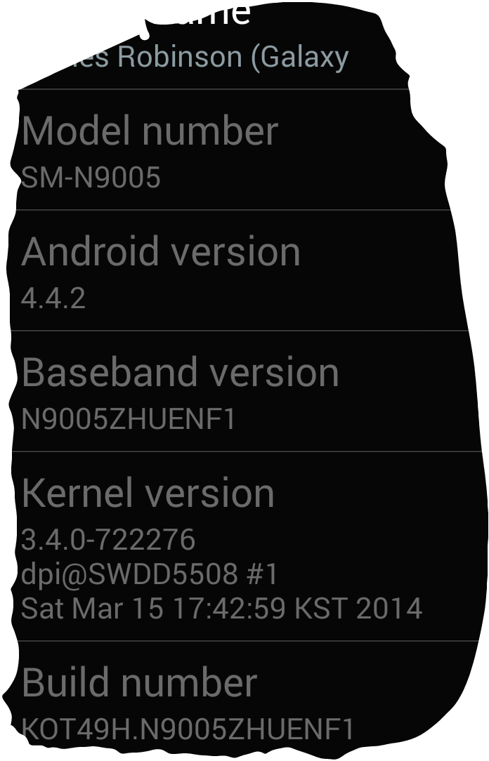

Hi
I have a note 3 which appears on the face of it to be running stock 4.3 but an Arab version! ? I get the same failure others have mentioned when trying to root with CF or flash a stock rom via odin, I have no option in settings to turn off the lock, I think it was introduced on later versions of android. In an ideal world I would like to root and flash a more current android version but at the moment even getting a newer stock fails saying there are no newer versions. .. which there are I think
Please help! !!
