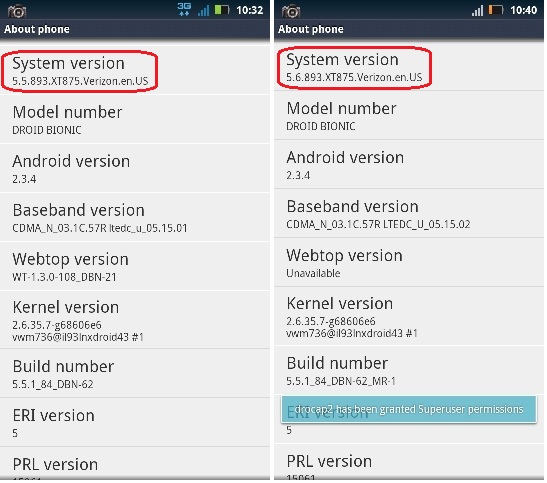

There are no roms yet. 5.6.893 is 5.5.893 with an lte fix. You can use the cheesecake way to get it but I have not seen a download yet.
Here's a screenshot of each update installed on my phone. I'll find the download link(s) as well, in a minute.
I can also tell you that there was some other text that popped up at the end of the install process regarding an LTE fix, or something to that affect.

I think you're supposed to update to 5.5 before flashing 5.6. That's what I did.

This is how I did it. Just like when you updated to 5.5.893, you have to be back to stock, full bloat. Then after you update, reboot, go into stock recovery and install the update 5.6.893.

Stock is full bloat on .866. The link you provided will restore you back to where you need to be ... just use option 1 when you run that script.
