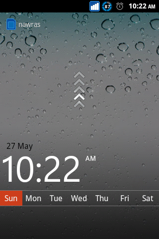

I am using the value curlockscreen=1 and am impressed with the lock screen I got. It unlocks vertically up only, but nice font and graphic.
Bro, this type of lockscreen comes even with curlockscreen=2!
And for Gingerbread lockscreen you need to REMOVE the curlockscreen line completely!
Aayush
Sorry, it was a typo. The lockscreen I posted is corresponding to curlockscreen value of 2 as aayushdutta has pointed out. I have not tried value of 1. (Earlier, it was 102, I changed to 2 and not 1).
