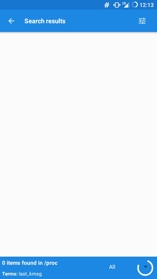

My phone crashed 4 or 5 times today, (screen went black randomly) only started working after I held the power button to reboot it. After each time the LTE wouldn't stick unless I switched the preferred thing to 3g and then back to 4g. I don't think I changed anything on the phone in the past two days. I'm assuming it will happen again, so when it does what logs should I try get and how? This is on the newest 8/19 build I think

I see this once in a while. If there a last_kmsg available then that's what I need. I just don't know if this kernel is always giving that to us.

Where would I find that without a computer? I installed and ran SD maid this morning thinking maybe there was a broken file somewhere so that might have deleted it, I hope not.

It's in /proc. The cm file manager should be able get it if you run in root mode. 3c toolbox can also grab it for you.
Why is this not working?

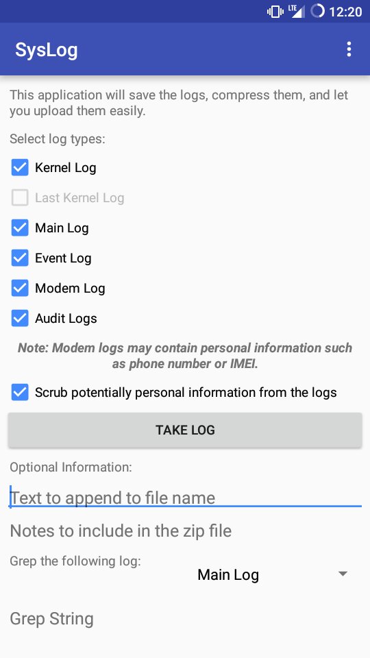

Tried it with 3c also. Not finding it. Oh well, it hasn't crashed since so I guess if it does again I'll try getting the log then. Thanks for trying
OK this is a bit of a stretch, but try editing /sys/module/printk/parameters/always_kmsg_dump and change from N to Y. The next time the phone freezes, make sure to hold the power button to reboot, pulling the battery will definitely lose the log. I know you said you were holding, but this also goes for anyone else who might have reboots.
