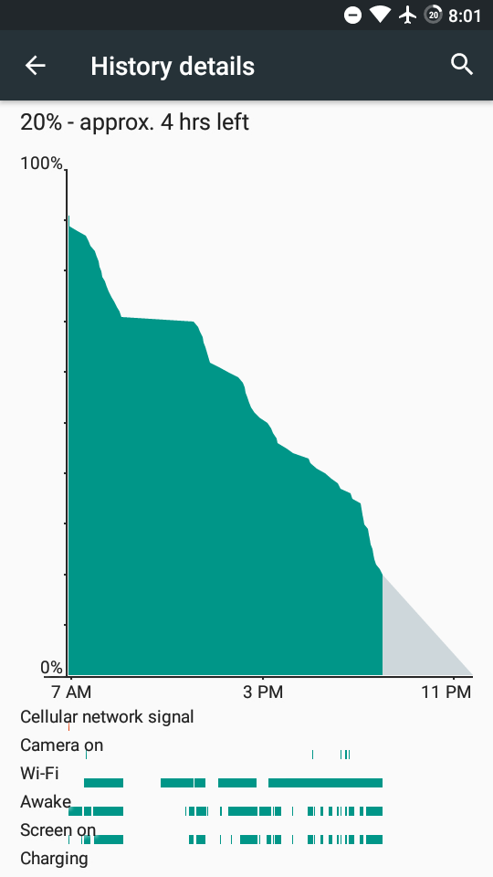

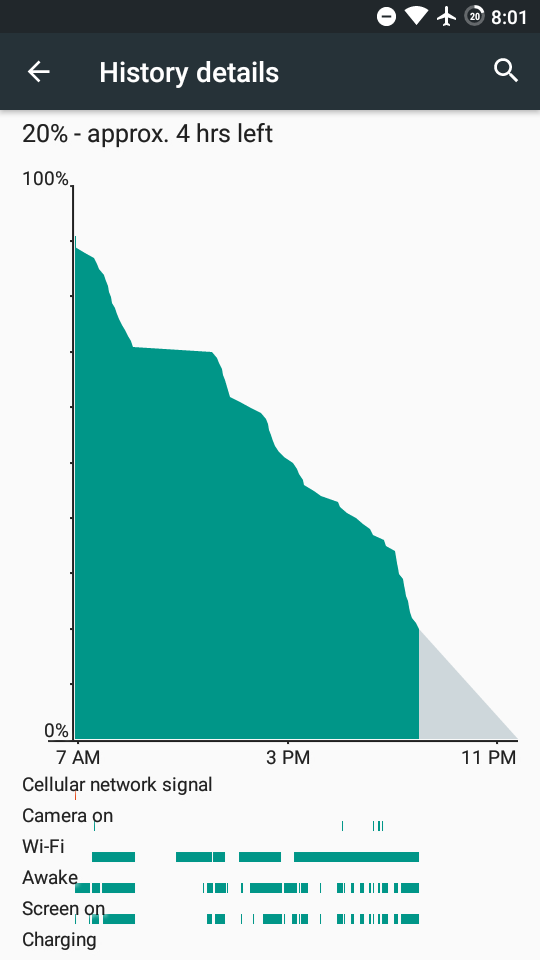

So thoughts on this? Unplugged at 5:30 am, mid-heavy use. YouTube for about 3-4 combined hours, Google Play music, WiFi on most of the time, and I have Greenify and Amplify installed. Also I deleted NFC like Spock said. I got pretty much the same results on CM11 but didn't have any battery savers installed.
Youtube would especially kill it, and maybe Google Play music as well. If your phone isn't asleep it's sucking down power. Best you could do is turn down the screen brightness. Give it a few days, maybe you had a bad charge. If it continues, consider using Better Battery Stats to hunt it down.
NFC will definitely play into it. I was using Amaze File Manager to delete the NFC service. Pretty much killed off the drain. With my light use I could get 2.5 days out of a charge.
Is there still a bug somewhere that causes battery drain when you disable NFC as opposed to deleting the NFC service?
