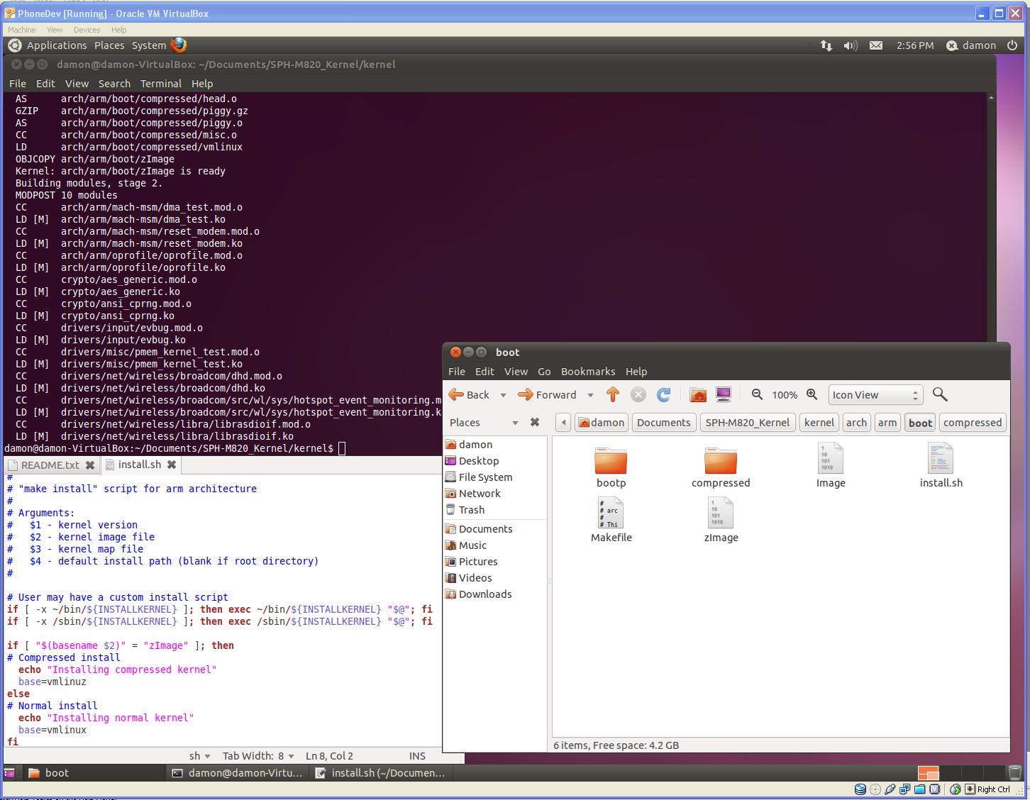

So, I see that people have said that the kernel for this phone wont compile. and me, being a noob too dumb to know better, thought I'd give it a try to see if maybe my test engineering experience could help find a solution.
Here is a screenshot of my results. It looks like it compiled. I have a zImage file and got no errors that I could see during the compile, just a metric buttload of warnings.
I'll also attach the zImage file in case someone is crazy enough to try it. I didn't change anything in any of the source files, just extracted the files from the tar.gz and followed the readme.
Please tell me I'm crazy and this doesn't work :)
well there are two kernel sources the ed13 which compiles with little or no errors, but does not boot
and ee14 that gives alot of errors during compile and does not boot
these images once compiled do not match the kernel zimage that is pulled from the phones boot.img, so samsung is leaving something out of the source
the compile kernel should match the kernel on the phone exactly, unless you change the config settings of the kernel source
hope that helps

actually both of them should compile with no errors, a shitload of warnings tho.. but all kernels have em (scary eh? )
I noticed that a lot of the warnings were for functions that were not used anywhere. That's pretty normal for code meant for reuse. Optimization should be pulling that unused code out to save space.
What does scare me is the items that give the warning that a variable might be read before the value gets initialized. I'm so used to looking at vital safety systems that it raises a huge red flag for me

Well, the hacker in me couldn't leave well enough alone.
So I sat down and was reading the documentation that came with the source and after reading through kernel/Documentation/Changes I found that I didn't have many of the packages they say are required in my virtual Ubuntu install. So I found them all in the package manager and now it's installing 237 new packages!!!!
I'll try a clean after that.
What's the fastest way for me to learn how to disassemble boot.img so I can compare all of the mad science I perform to the real deal?
which packages are you installing
Shoot, I can't remember which exactly were missing.
o Gnu C 3.2 # gcc --version
o Gnu make 3.80 # make --version
o binutils 2.12 # ld -v
o util-linux 2.10o # fdformat --version
o module-init-tools 0.9.10 # depmod -V
o e2fsprogs 1.41.4 # e2fsck -V
o jfsutils 1.1.3 # fsck.jfs -V
o reiserfsprogs 3.6.3 # reiserfsck -V 2>&1|grep reiserfsprogs
o xfsprogs 2.6.0 # xfs_db -V
o squashfs-tools 4.0 # mksquashfs -version
o btrfs-progs 0.18 # btrfsck
o pcmciautils 004 # pccardctl -V
o quota-tools 3.09 # quota -V
o PPP 2.4.0 # pppd --version
o isdn4k-utils 3.1pre1 # isdnctrl 2>&1|grep version
o nfs-utils 1.0.5 # showmount --version
o procps 3.2.0 # ps --version
o oprofile 0.9 # oprofiled --version
o udev 081 # udevinfo -V
o grub 0.93 # grub --version
o mcelog 0.6
o iptables 1.4.1 # iptables -V
I just went down this list in Ubuntu's package manager and flagged anything that was missing to install and accepted any dependencies. I think btrfs-progs I had to search for and iirc it was a part of btrfs-tools
