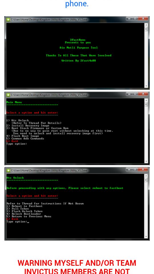

I most likely will use this to.root my device. But I have a few questions. To fully root my device do I go in order to correctly do it?
Just to be safe.
1st I do an HTC unlock
2nd flash custom recovery
3rd root stock firmware (boost)
4th flash boot IMG.
Is this correct? I'm just being safe and needs help from the experienced.

I was trying to use 2fast kingdom utility , and every time I do a command such as pull token it always says something about cannot find specific path. On everything I do. Can someone explain that for me ?
What is the purpose of a guide that has nothing in common with the design? Well it covers unlocking the phone but you will have to search for other needed things. Savage put together a good guide here http://androidforums.com/evo-design...tc-evo-design-4g-all-carriers-root-guide.html
How ever as for my tool, It was tested before I posted it by myself. Where if you are getting a issue like the above it sounds like you are extracting the files to some different layout. Install htc drivers, after installed remove htc sync. Download my tool and create a folder on the desktop under what ever name you like. Then extract the contents of the zip to the desktop.
Edit: Also for a little bit of info there is no rom that is flashable via the stock recovery. The rooted rom on here I believe is outdated. Along with it is flashed via h-boot which isn't recovery.

I really haven't had a chance to get to it, I just got out of football practice. I have actually tried that guide the only problem I have is after downloading the SDK files needed (SDK tools, etc) there where two I believe. And I have searched high and low trying to find them because I need three other files from those (fastboot, etc). But I can't find the two I downloaded on SDK manager it says there installed but doesn't let me browse the downloaded files. I tried for three or so days and gave up and tried your tool but that always says "couldn't find specific path".
