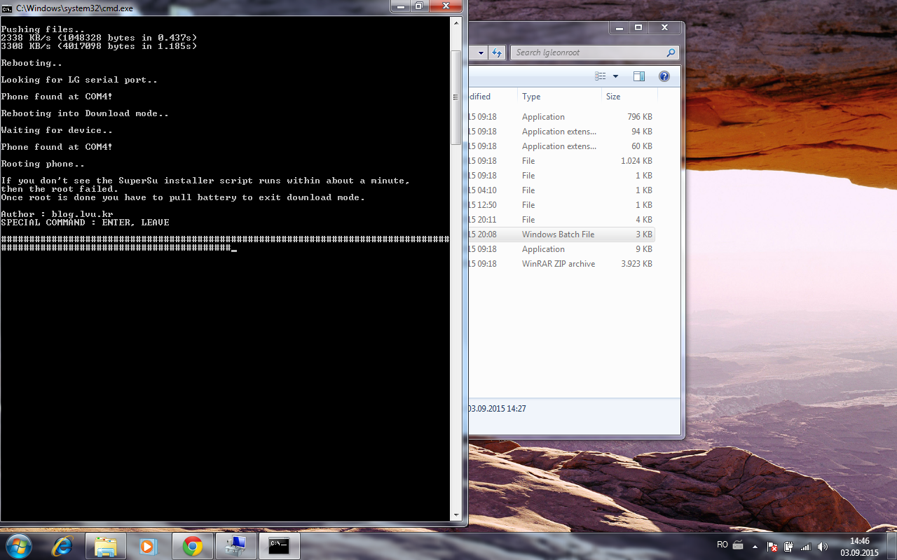

i wait 10 min and nothing .... please help me . lg leon h340n 10d version

I still can't get this to work.
I've updated all my drivers, enabled oem unlocking, booted into download mode manually and let the bat file do it, and still nothing.
LG Leon LTE - One Click Root
Written by @CamoHiddenDJ
Based on script by nbreunig3
Please make sure that USB debugging is enabled, and LG drivers are installed.
Starting adb server..
Waiting for device..
Device detected!
Pushing files..
2274 KB/s (1048328 bytes in 0.450s)
2676 KB/s (4017098 bytes in 1.465s)
Rebooting..
Looking for LG serial port..
That's as far as I get.

Hi but i have to execute run.bat or use the text command?
Attached the result of running root.bat
seems to be a port problem...after rebooting it changes port from 8 to 10....

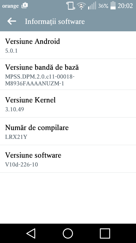

Android
5.0.1
SW version
V10e-EUR-XX
