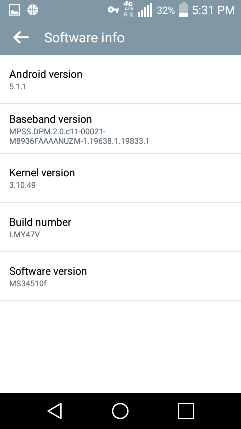

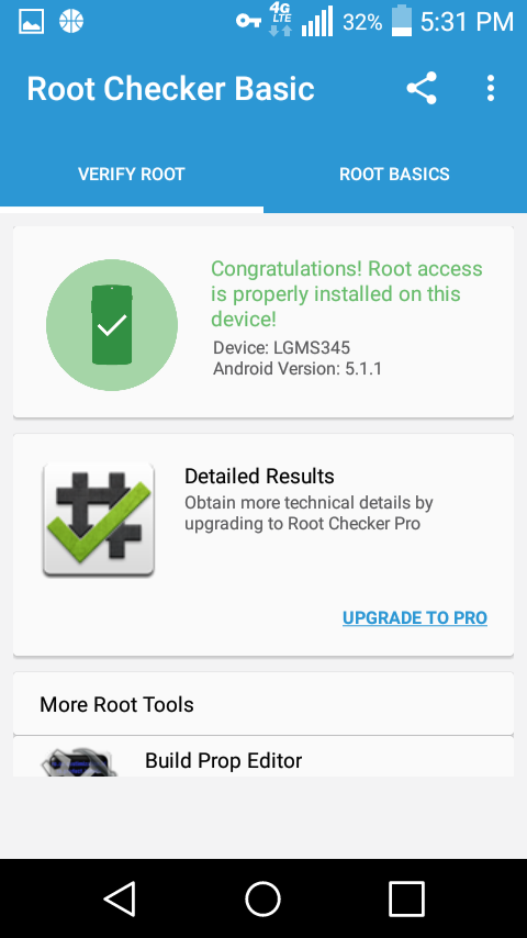

Screenshot_2015-11-01-17-31-10.png Screenshot_2015-11-01-17-31-36.png Screenshot_2015-11-01-17-31-10.png Screenshot_2015-11-01-17-31-36.png

Can confirm that this method works for LG Leon 4g LTE ms34510F

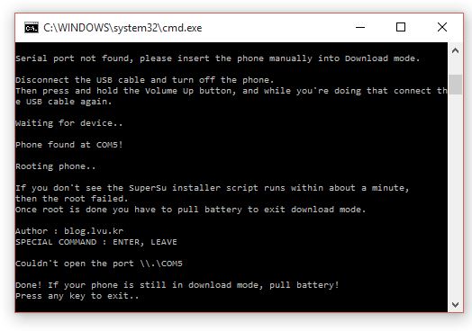

this driver update has gotten me a bit further, still researching but this caused it to be recognized at download mode step.

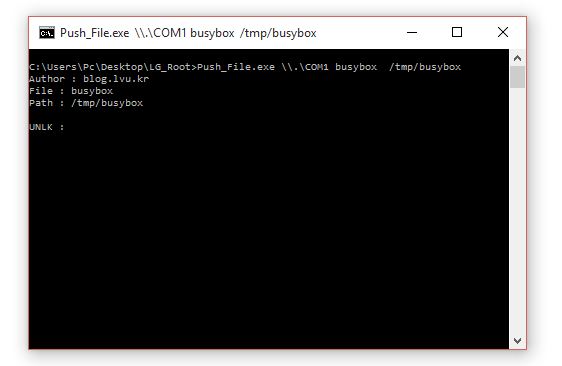

UPDATE #1: shift right clicked in folder where I unzipped files to, opened command prompt from context menu, typed:
Send_Command.exe \\.\COM4 < root
Pulled battery rebooted
This seemed to root phone but I cannot verify it actually worked yet.
Update #2
I went here and followed these steps even though my device was not bricked
http://androidforums.com/threads/unbrick-guide-lg-leon-lte-metropcs-lgms345-kdz-firmware.923914/
I then after downgrading to version d ran the root.bat which pushed the files and failed at download mode again. That was expected. I pulled battery and got into download mode ( volume up + plug usb cord into phone. I then opened device manager and clicked the lg mtp device ( i did install the updated lg united mobile drivers from the unbrick forum prior to this step ), right clicked and chose properties then browse my computer then let me pick from a list, then i selected the lg mtp driver and clicked next until it finally installed fully. I then repeated the steps in UPDATE#1, after root installed fully and I clicked cntrl+c to exit, I simply pulled battery and rebooted phone. Root is verified!

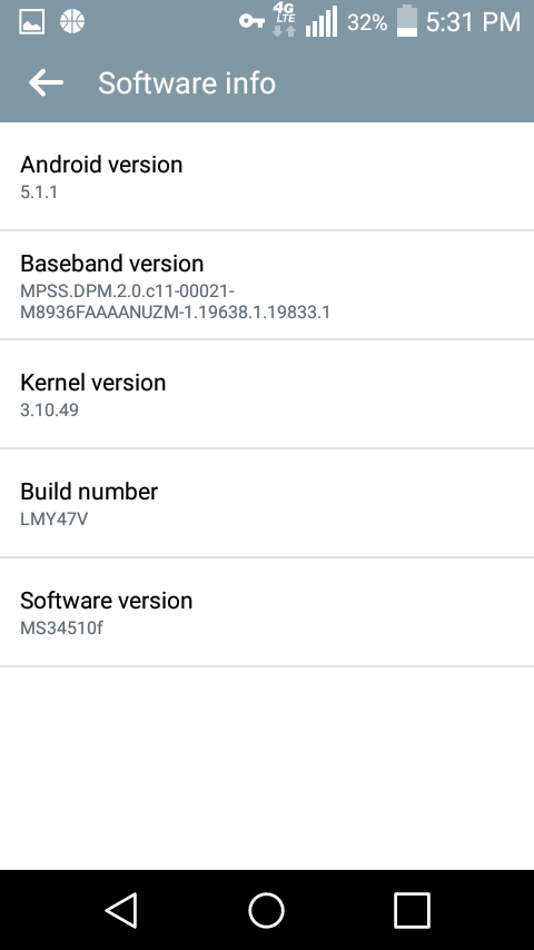

View attachment 96295 View attachment 96296 View attachment 96295 View attachment 96296
