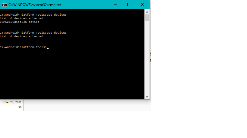

i understand but im having trouble doing so, idk if something i have installed isn't right or what but its not working for me, when i do the volume down and plug in i get no devices/emulators, ive tried to google the fix for that but none seem to work
when its turned on in usb debugging mode and i type in adb devices it gives me the serial number but when i power off and do the volume - and plug it up i get no devices listed
this is when its powered on then when i do the volume down and plug in

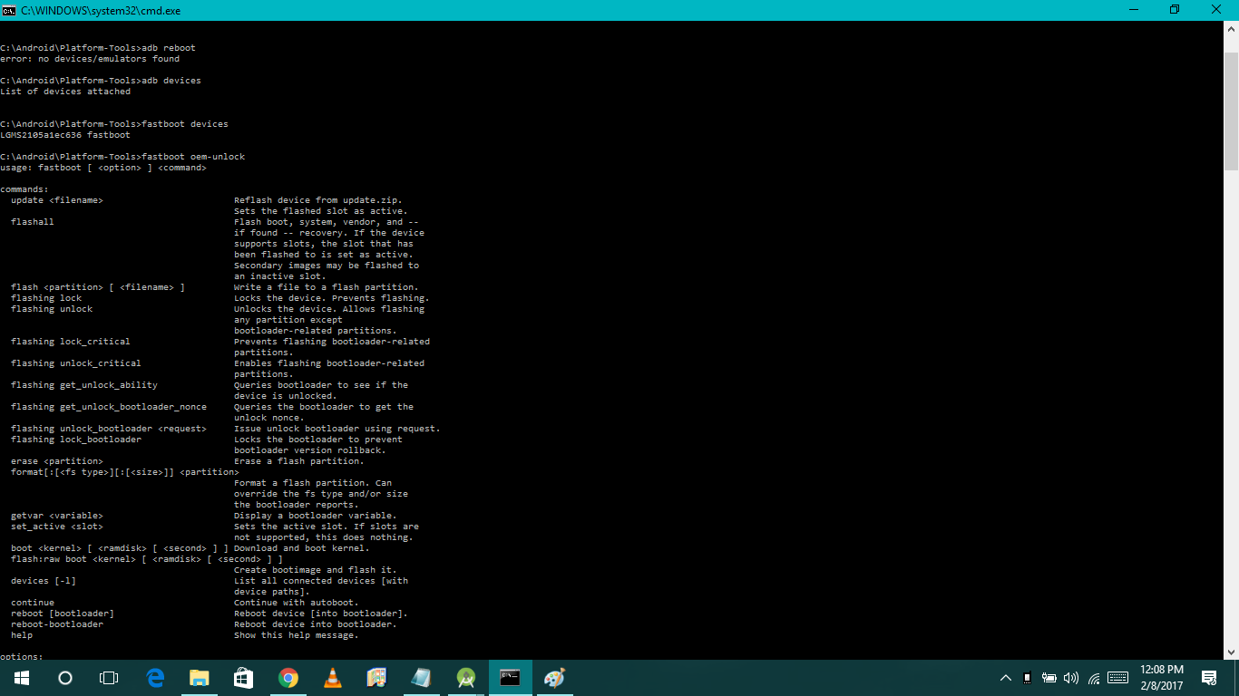

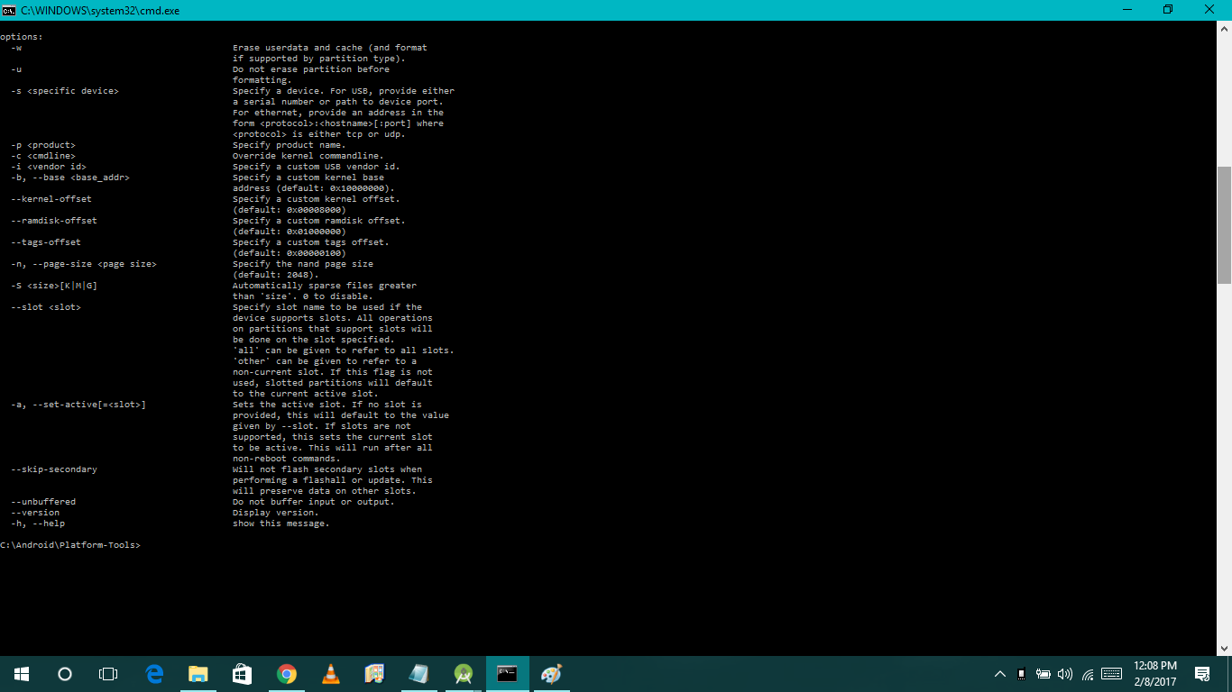

ok, did what you said and did fastboot oem unlock how do i know if it worked?
Well it doesn't appear the unlock worked but you do have an active fastboot connection so you're close. Couple things to try on that. Firstly try removing the dash in the command. So switch to simply fastboot oem unlock.
If that doesn't work (it will tell you if it's successful rather than bringing up all that other text like you're seeing), then be sure you checked the option to "allow oem unlock" in developer settings. You can't unlock without having done that first.
