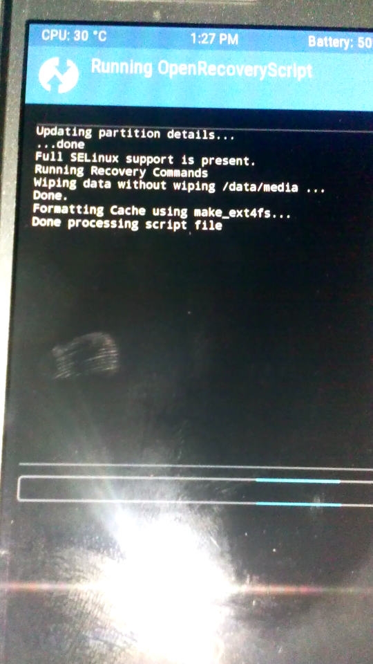

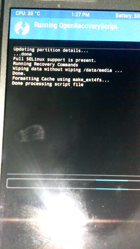

So I got bored today and decided to factory reset, still had both zips on external sd card. Tried getting to twrp menu but this kept happening. I thought i figured it out yesterday, not today.
I've tried different button and on/off switch combos
A Iittle googling and I guess i should have allowed write access to the system partition, and that stock recovery is overwriting twrp.
Flashed twrp and still get the same screen. I cannot get to twrp menu. Phone is oem unlocked. I'm lucky that phone still boots to os.

Grab stock lgms210.kdz from lg support. Grab LGUP for windows. Grab appropriate drivers and .dll for common folder in lgup folder, if common folder is not there google it and make one, simple copy paste. Grab a program called uppercut for lgup. Go completely back to stock since youve already erased everything, then follow instructions on twrp page exactly as stated, and remember to enable system modification and decrypt your data :)
Odin89 thanks for the reply, couple of questions. My aristo is fully functioning, boot loader unlocked; do I have to go thru this process to get twrp working? Also i have the tmo aristo, will the lgms210.kdz work?
I believe tmo varient you have to give the lg site your imei to recieve stock kdz. And I honestly cant say that the entire process is required, could be something simpler, but this would be the one way to one stop shop it for sure and get back to a state you know for sure has nothi g tweaked, wich is what you need to follow messis tutorial :) also bootloader will stay unlocked after going back to stock, mine did.
Got root again. Found uppercut, lgup, and used LG M210SV firmware + disabled virus protection. Flashed recovery wiped and installed zips. Verified root and rebooted to twrp with reboot app. twrp menu loads. Thanks for the help.
