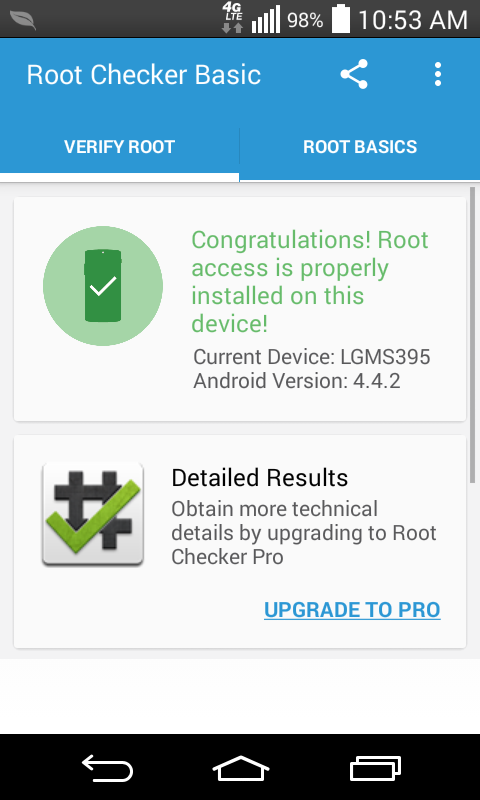

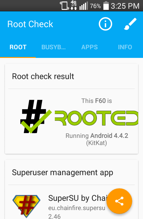

Thank you! My LG F60 is now rooted! Awesome! I had a bit of difficulty at first but I just had to get windows to install the LG drivers. A bit freaky when I saw the phone showing updating firmware and at the end I had to pull the battery even though the phone progress bar didn't move.

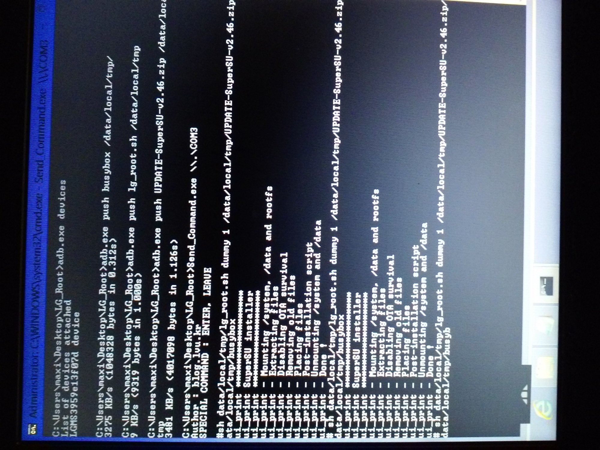

I have made a zip with everything you will need
1.) Enable Developer Options by tapping build number Settings> About Phone> Software Information until you are presented with "You are now a developer"
In Developer Options enable USB Debugging (Enable PTP for debugging to work)
Open a command prompt in the root of this folder copy and paste the commands one by one
adb.exe push lg_root.sh /data/local/tmp/
adb.exe push busybox /data/local/tmp/
adb.exe push UPDATE-SuperSU-v2.46.zip /data/local/tmp/
2.)Put your device in download mode (while powered off hold volume up and plug in usb until download mode is shown)
3.) In command prompt in the root of this folder run the below command
(To find which COM port your device is under open device manager and click ports and your device port is listed under the drop down menu)
Send_Command.exe \\.\COM5
After running this command on the correct COM port you will be presented with a root shell # symbol
(In the root shell execute the below command via copy+paste)
sh /data/local/tmp/lg_root.sh dummy 1 /data/local/tmp/UPDATE-SuperSU-v2.46.zip /data/local/tmp/busybox
You should see something happening and not a return of a blank command. Once it's finished pull the battery and boot up your device is rooted
