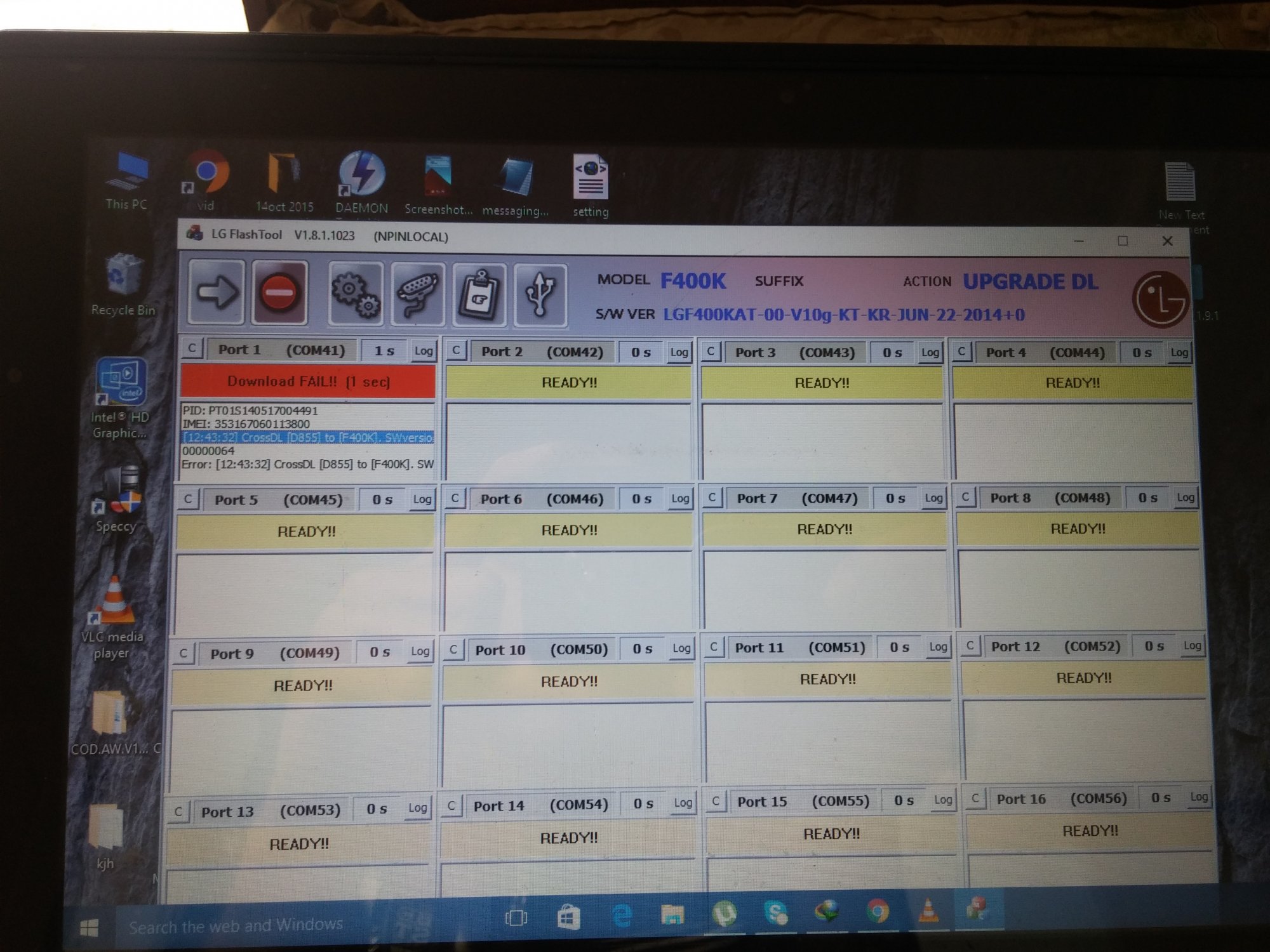

hello dear iowabowtech, i purchase lg g3 f400k then i install custom recovery twrp 2.8.0.0 in my g3 after that mistakely i install lg g3 d855 custom rom montary 8.3 in my lg g3 f400k when installtion completes my lg g3 go to fastboot mod started.
then i remove battery and insert it again and press volum up button and plug usb cable in lg g3 f400k my phone go to download mod. but when i install stock firmware via tot method error comes like ''I SHOW YOU IN PICS'' how fastboot mood started and how firmware update failed in tot method .sorry for poor english. sir please save me from terrible situation by helping me.

i buy lg g3 f400k then i install custom recovery twrp 2.8.0.0 in my g3 after that mistakely i install lg g3 d855 custom rom montary 8.3 in my lg g3 f400k when installtion completes my lg g3 go to fastboot mod started.
then i remove battery and insert it again and press volum up button and insert usb cable in lg g3 f400k my phone go to download mod. but when i install stock firmware via tot method error comes like ''I SHOW YOU IN PICS'' how fastboot mood started and how firmware update failed in tot method .sorry for poor english. sir please save me from this situation by helping me.

You should be able to use your working download mode to restore with a tot. You will need to hexedit your f400k tot to read model d855. Once that is done, you will then likely need to use a different DLL than you have been currently using. I'm not sure if this is the correct generic DLL for bypassing the cross DLL error on the G3 but it appears it may be:
http://downloads.codefi.re/autoprime/LG/LG_G3/LGUP_8974.dll
When hexediting the tot, search the tot for the first instance of the f400k model number. Directly after the f400k should be the s/w version you're using which I only mention as a point of reference. You should edit only that very first instance of f400k to read d855, then save and exit. Since in this case you are dealing with changing from 5 characters to only 4, you'll need to be sure you've zero'd that last digit. You must not change the total number of bytes or the order of those bytes both before and after the model, or it will not save and will not work.
Protip: always keep a copy of the original tot on your pc. That way if you make an error editing, you don't have to download the entire tot again.

sir when i hexediting LG G3 F400K tot, i convert f400 to d855 but please tell me that what i do with K character. can i erase k character??
sir iowabowtech i show you in pics how i hexedit g3 f400k tot please tell me where i do mistake. i also use both f400k.dll and LGUP_8974.dll with hexedit (modified) g3 f400k tot.
after hexediting g3 f400k tot when i procced to lg flash tool error comes ''failed previous load()''
sir please help me i am in big trouble.

I found it easier in retrospect to search "800" instead. The instance you have edited is not the right one. Here is the string you are looking for:
And here is edit I made to add a blank byte (00) after the D855:
So F400k becomes D855.
That way you start with 5 bytes in the F400k and you still end up with 5 bytes with D855. <--due to the period (or zero, zero which is a blank byte)
In my hexeditor, I had an issue adding a period in the right most editing window that reads the text, so I instead edited a new 00 into the mix by using the main, leftmost area where all the bytes themselves are shown. You can edit in either place. So basically, I placed the cursor at the end of the D855 (the right most 35 in the highlighted text above) and then just typed 2 zeros to add the blank.
i use Hex editor neo and also use replace feature of hex editor for changing text of f400k to d855 but same error appears in flash tool please help me.

dear sir can you please upload modified tot for me i am really thankfull to you. my hex editor is different
and i am unable to modify my tot file please after uploading to google drive send me link .i hear about you that you are life saving person for bricked device.
sir don't upload tot for me. IOWABOWTECH you are MASTER of masters, billions of times thanxxxx finally i solve my g3 issue :) by carefully noticing your last post you are GREAT thanx again you save my device god bless you.
