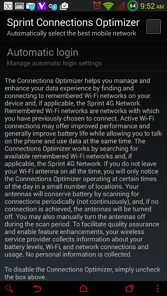

It's not random. That's the work of Connections Optimizer due to having detected an open network and assuming that you would want to be on WiFi. Turn off Connections Optimizer.
Like he said, this is the stock software. He didn't create any of it and has no control over it. This is exactly what is installed on your phone with the zv5 update. All he did was add root and busybox and deodex the ROM. Any operational complaints should be directed to LG.
Thanks so much I always wondered what that dumb seetting did. Thanks for clarifying appreciate it. Also When you say busybox is installed to the ROM does thta mean I don't have to install it from the play store?
No you can turn it off in the settings
Well that sucks out loud. :(
On mine, it's Mobile data, Automatic connections, and then just uncheck the box. :(
No idea why they didn't give you that, but it's why we root, isn't it?
It's not their phone!
EDIT -
Never mind, I'm blind.
I thought you said can't. :p
EDIT -
We have that, although it's actually titled Connections Optimizer. I did something that broke it on my phone, so I uninstalled it, which is unfortunate since it also stores public WiFi connection settings so it can automatically log in.

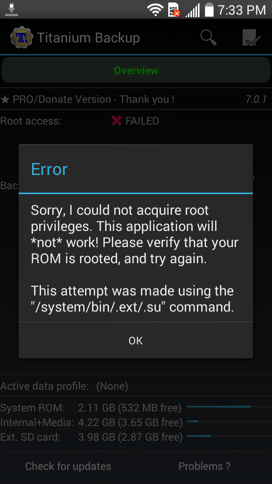

I installed the deodexed zv5 and when i go open super user is says i am not rooted. Any ideas? :c
edit- flashed the odexed zv5 and now i AM rooted. thank baby jesus but I am aiming for the deodexed build. Any ideas boys?
That's strange, the odexed ROM should be rooted just like the odexed one. I'll check it out and see what's going on.
I had that problem too, but not the first time I flashed it, only after flashing CM12 and going back to it did I encounter this problem.
Tried deodexed again and still said it didn't have root. Back to odexed but don't have 4g anymore and can't seem to find a fix anywhere? Has anyone seen a fix or know of?
