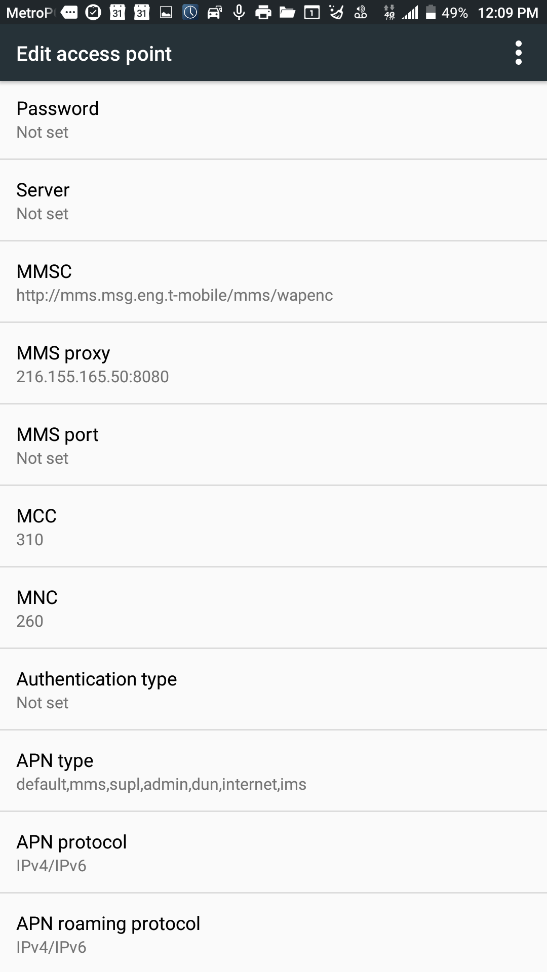

Switching course... instead of calling Metro:
1. Updated E-911 address in My Metro App... being it's a new phone, and various issues crop up without it.
2. Home - brewed apn.
A. It has all Tmo settings EXCEPT for one - The fast.metropcs.com... fast Tmo no longer works on Metro.
B. Also added IMS to apn types BUT no hipri per Krlypumaa http://androidforums.com/threads/signal-data-issues-fixed.955489/
C. IPV4&6 default and Roaming.
3. Going back to disabling, for battery life, Wifi Calling & Location... all the apps that need the latter have it allowed in Permissions & hopefully can access on demand.
Gonna make a new thread on this, to șee if it passes the smell test.
REMOVING IMMEDIATELY IMS, calling developed problems!!!
