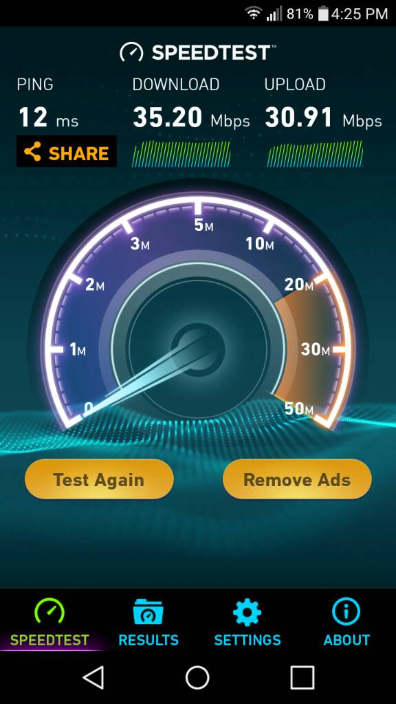

I did 2 factory resets and wiped both cashes just because of your postings about your wifi. The pic is in my mancave dungeon and this is pretty consistant.
