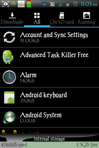

Ok these steps are quite simple works it roots and causes your partition to become internal memory on the merit/avail

The pics are simply to prove that its working there of my phone. Thanks goes out to the creators of AreaRom-Z990-v2.2.3-NW
