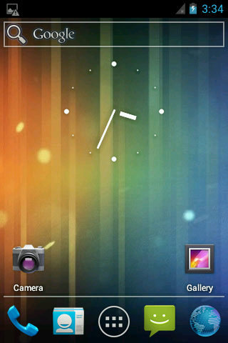

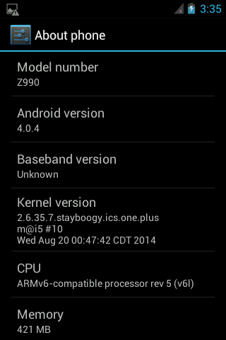

Root [Merit] ICS is coming...
just some screenshots

from the screenshots I see that the signal bar doesn't seem to be having signal is that one of the issues you are facing?
i didn't have the sim card in it. i'm working on this device and my new ZTE OpenC that i got two weeks ago, and the sim card is currently in that phone.
