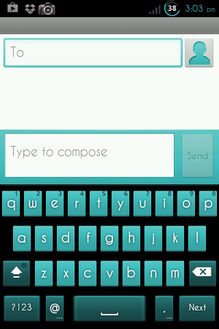

Fonts are very difficult to read and should be
changed. Launcher works very well, and I iinace
MH-1.1e also set it as the default. I have a problem
with GALERIE that shows no picture, so I changed
it. Maybe you're too filled system memory, and I
would put the app such as maps, dolphin, calculator
and some more, to be installed later as a user on
sdext partition. Blue theme I really like it and it's
good.

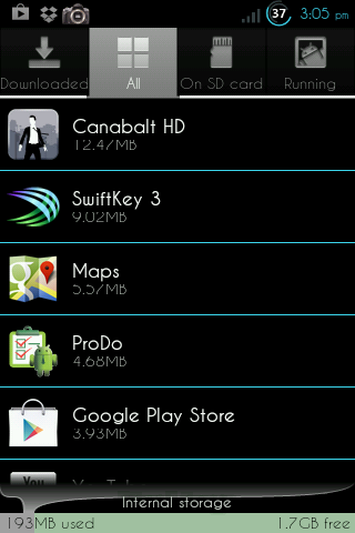

Personally the only thing that stops me from flashing this ROM is the fact that it comes pre-installed with software that I have no desire to use. Sort of reminds of why I rooted my phone to begin with.. To get rid of pre-installed junk. Props for the job well done though.
I know I could simply remove them once flashed.. but still. It should be a clean minimal install to be considered a "slimmed down" version of the original stock ROM.
Fear not, version 1.1 willbe ready in about an hour.... This version will be basicly themed empty space. since that seems to be the biggest gripe.
If you do happen to flash this rom, make sure to compare the space you used to have with the space you have now, I would venture to say that it has been slimmed considerably.
I configured v1.0 for my tastes, as I habitually take care of #1 (me) first. V1.1 will cater to everyone else
EDIT v1.1 is available, same link, same install procedure, only now you can expect 149mb free for user apps (91% free) and 68 mb free for system apps (31% free)
