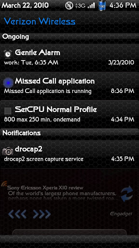

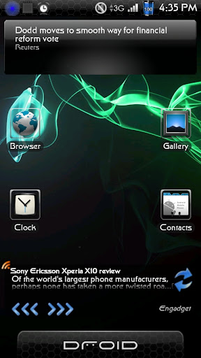

The new Hexfusion for 2.1 Roms ONLY: [MM Theme] HexFusion for 2.1 (ERE25) - Droid Forum - Verizon Droid & the Motorola Droid Forum
I wasn't a huge fan of the original Hexfusion, but I love this one!
All of the icons have that border around them. The font is also apart of the theme.
The pulldown shade is looks really nice too. I don't think these pics do it justice...or I just like it. Regardless, I definitely thought it was worth mentioning.
