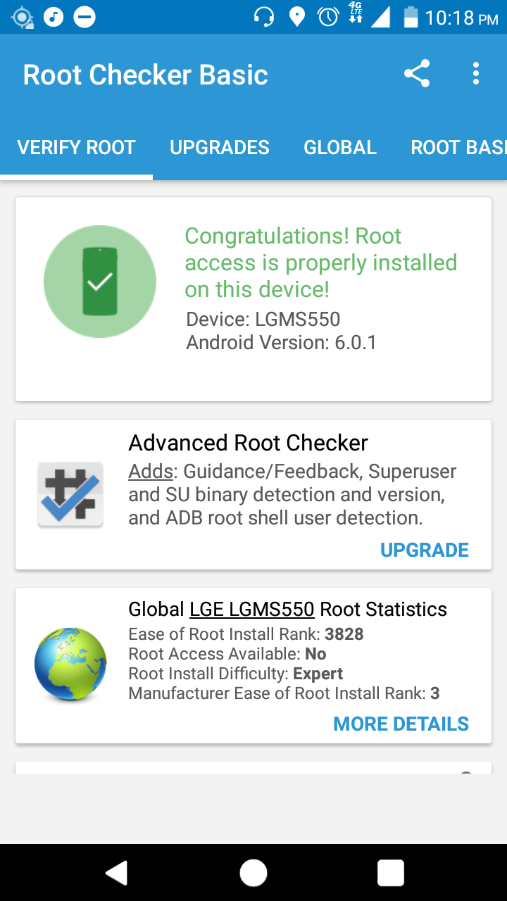

I'm on MPCS and I flashed the T-Mobile.kdz because I reflashed stock with lg up and couldn't get root back.
Then I flashed the .dz tmobile and I was able to root it again. Twrp would not let me enter via adb commands.
I like the tmobile bloat,wallpapers better than mpcs..shhh don't tell anyone.lol.
So in a nut shell my lg g stylo plus 2 rooted with xposed is running better than my un rootable zmax pro.
