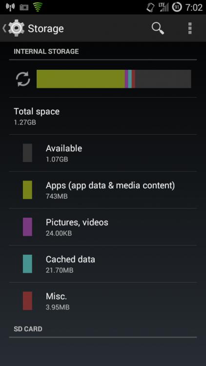

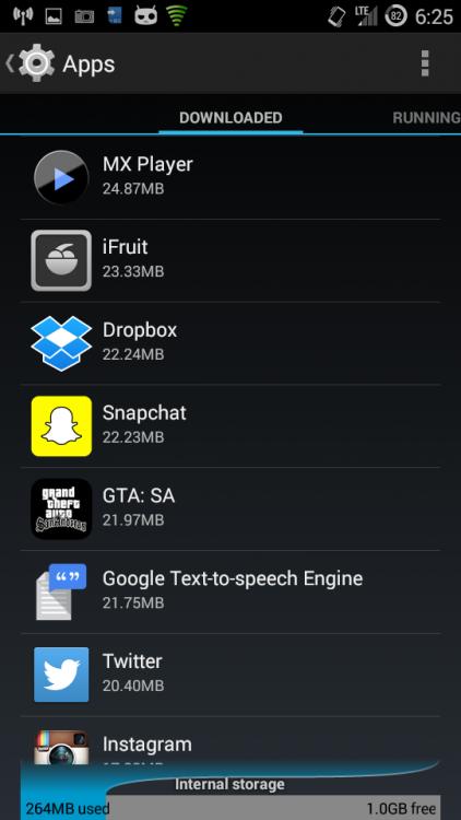

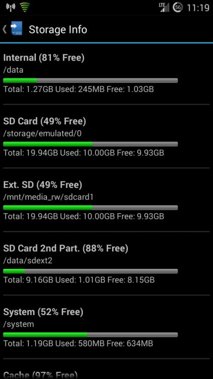

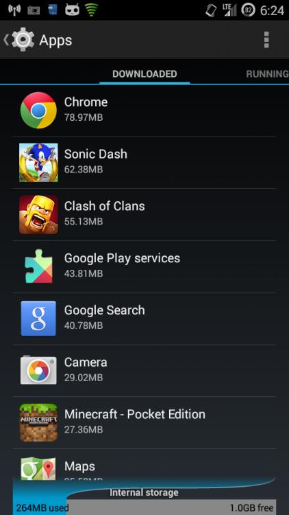

After searching around the interwebs, I think i may have found a working storage solution for CM11. I'd appreciate it if you guys use this and test this out.
First things first, You will have to Format and create 2 partitions for your sd, fat32 and ext4, We will also need to use link2sd,(Practically the same way we have been doing already.)
This time it you will require a computer since it seems the external sd card can't be unmounted on Kit Kat.
You can use any partion application on a desktop, in my case i used minitool partion wizard.
Use Gametheory's guide located below for a full setup.
*Aparted can not be used anymore*
*Gt's Guide: How to setup Link2sd
Onto the next step,
Download the New CM11 storage mod and flash it in recovery.
Boot back into CM11 and go into settings/storages
If you did everything correctly, You will see that external sdcard is empty and the internal is still the 1gb. From now on, data will be downloaded into your sdcard and the internal storage shouldn't be effected.(aslong as you set link2sd to automatically link apps to your sd card)
Happy downloading :)​
To install apks from your sd card, read post #23
Thanks to GT for his guide, the creator of the mod Crashdjent and Jokerpks for the sd card install fix

I seem to have put more memory for ext4 than i should have lol
