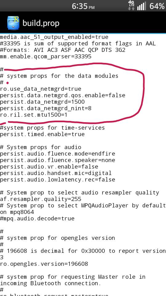

Here try this to see if the lagging goes away...
ALWAYS MAKE A BACK UP....
DOWNLOAD
http://www.mediafire.com/view/lqp7bwwn23n7i41/99_2000MI_7000ME_sd_cache.txt
Instructions...
** copy n paste in system/etc/init.d
*** permissions rwx.rwx.rwx (0777)
** open S.Manager look for it.
** same as sd hack open as sript.exec..on it
1.fav
2.su
3.boot
4.bg
Save it and exit
After that...
Open build.prop
Edit the lines ** system prop for data modules**
Add this line
Under
persist.data_netmgrd=1500
persist.data_netmgrd_nint=8
ro.ril.set.mtu1500=1
Save. Close...
And restart ph. twice
