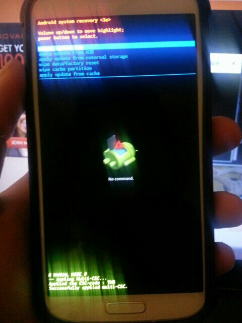

I really wish i could get a pic of what ur seeing. Try installing TWRP with goo manager. If that doesnt work, try another recovery. Install goo manager then tap the menu button and select install open recovery script and do what it says.
I did that in goo manager a little earlier it downloaded and everything then i hit reboot recovery but it doesnt do nothing but give me a message. Then I tried to flash that file in goo manager but when I hit flash nothing happens there too. I'm still trying to post the picture also
IDK man, lost of people have installed TWRP both ways with no issue. I've never heard anyone describe what youre seeing. Try the oudhs recovery or CWM.
Are you sure you have a MetroPCS S4?
It says it's for Android 4.2.2 does it matter if I'm on 4.3? Sorry I meant to quote your other reply.
