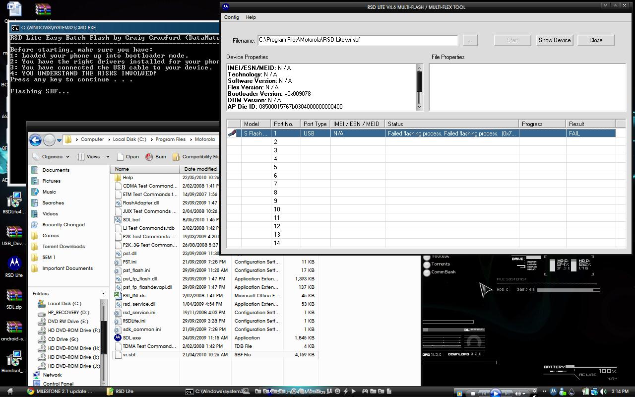

this is quite annoying, i dont know why im having such a hard time doing this.
i reflashed my phone. let it reboot and it asks to setup phone, but i turn it off.
turn it back on and go to bootloader 90.78
try flashing vulnerable recovery, by dragging the sbf onto SDL.bat
but i still get a fail.
can anyone help ?
can anyone help ?
What is the error code? I can't see it because it is cut off.
