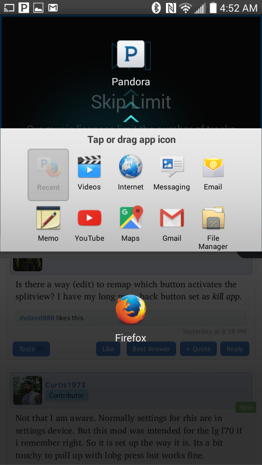

How to use :
After boot up long press the back button until the splitview panel appears. Then pick the two apps you want to use. One for top and one for bottom. Can exit by pressing home.

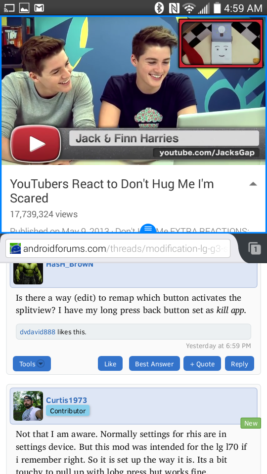

Would this work on Bliss Pop or Candy ROM, CM12?
Is this only for the stock home launcher? Im not deodexed either so that could also be the reason I cant get it working. Edit - nevermind just get force close popups. Not a good idea to install stock odexed.
Not that I am aware. Normally settings for rhis are in settings device. But this mod was intended for the lg l70 if i remember right. So it is set up the way it is. Its a bit touchy to pull up with lobg press but works fine.

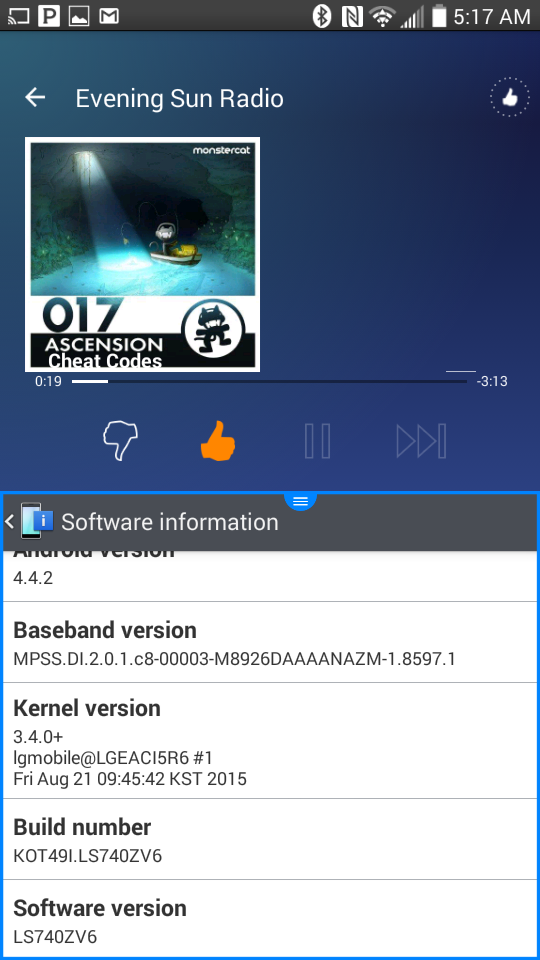

I tested this on ZV6, seems a bit glitchy but once I manage to activate the split screen menu it works fine. Can this be tweaked to work better?
Going to try to make the long press last a bit longer to get it to pull up better. As for hashs remap issue. Using g2 I just remapped long press on either home button or menu button for kill apps function. Works fine. Im testing the pull up glitch now. Will let you guys know.
Looked at making changes to the build.prop for responsiveness but not helping. Im able to pull it up fine once the timing is right with my long press. Leave button vibration on in settings it will help you get the feel of when to let go so it comes up ok. For me as soon as the vibration stops i let go. It usually pops up fine. Will keep plugging away at it.
At least for me I have it coming up every time now. Button vibration is the key here. As soon as the back button long press vibration stops...let go. It will pop up. If you hold to long you'll glitch it out. Do a reboot and then practice the timing of press. It will start popping up every time.

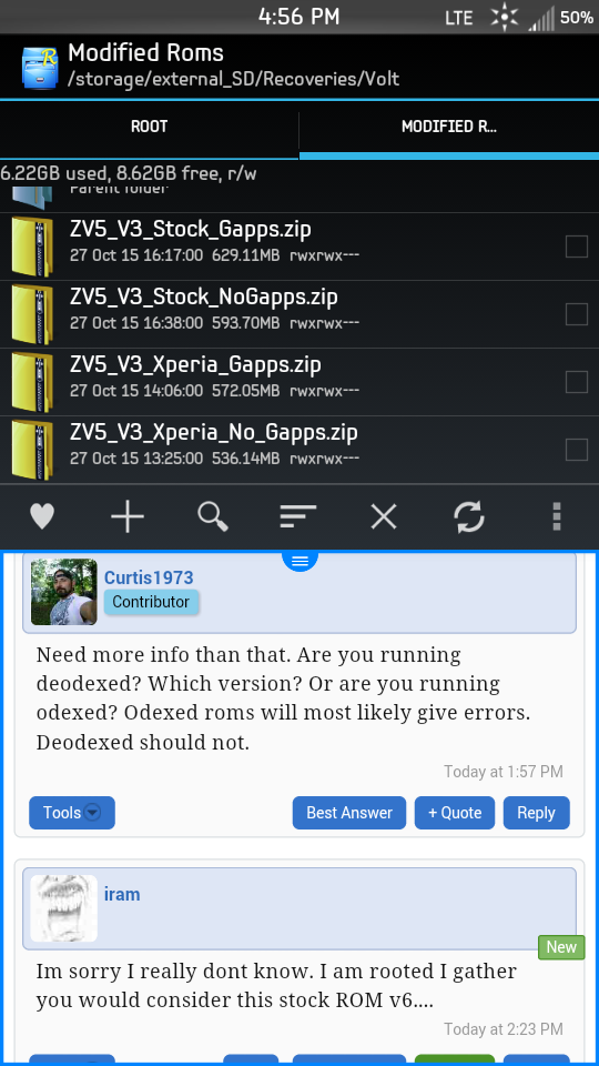

Need more info than that. Are you running deodexed? Which version? Or are you running odexed? Odexed roms will most likely give errors. Deodexed should not.
Im sorry I really dont know. I am rooted I gather you would consider this stock ROM v6....
If you are rooted and have twrp installed then I suggest trying out the original zv5 deodexed,zv6 deodexed xperia by shapeshifter499 linked in my zv5 thread or even the zv5 roms ive uploaded. Plenty to pick from.
