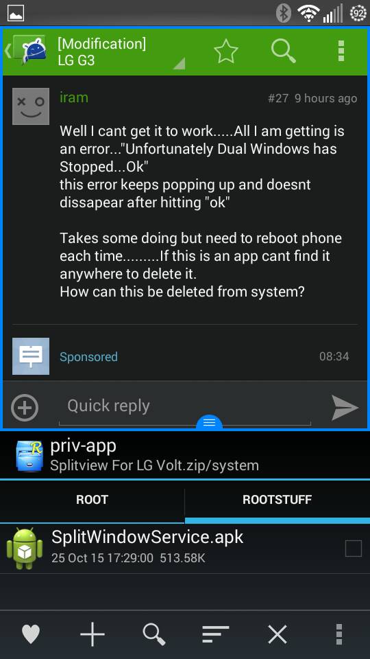

Well I cant get it to work.....All I am getting is an error..."Unfortunately Dual Windows has Stopped...Ok"
this error keeps popping up and doesnt dissapear after hitting "ok"
Takes some doing but need to reboot phone each time.........If this is an app cant find it anywhere to delete it.
How can this be deleted from system?
Working here... The app is in priv-app... there's some other files to, look in the zip for their locations.
Thank you....found apk and deleted it..hope that solves problem.....wondering if there are similar apps available that may work
