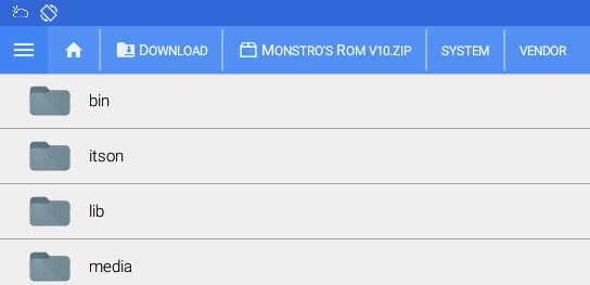

One thing to note-- I was unable to find the /carrier/itson folder that is mentioned in the install directions. I installed the rom and explored all (well, most, lol) of the folders in TWRP, but could not find the folder. However, the rom started fine; Did I need to open the .zip and delete it from the package prior to installing? The directive in the instructions isn't that clear, IMHO.

Anyhow, I found the folder I was looking for. It was system/vendor/itson. Upon deleting it, the phone will now turn off/on properly, and I am getting a stronger signal. I used a root browser and deleted it right off the phone and rebooted. Do I need to actually extract the original .zip and remove the folder, re-zip, and re-install, or ya'll think what I've done would be sufficient? As far as the non-starting thing is concerned, that's fixed... Could this have anything to do with my BT problem?

That's odd, because I found it in the zip for the rom.
Edit: i went back and re-read your first post, and I believe I'm understanding now... You're saying that I would need to delete that folder from my phone PRIOR to flashing your rom, eh? I see. So... Being as I didn't do that, am I fubared over here, or what?
Well... First I deleted /itson out of the .zip, sent it to my sd card and attempted to flash it; of course, that makes the flash fail. So then, I performed a wipe with TWRP and formatted /data, and then flashed the original zip, and I'm met with the soft brick. If deleting /itson from the rom .zip isn't the way to do it, and there's no way to delete the folder from TWRP, then I'm obviously missing some kind of step.

Okay, well I'm confused, because it most certainly is in the zip I've downloaded. Anyway, moving on...

system/vendor/itson isnt the right folder

Look, guy, i read that, okay? My point was, the language isn't exactly clear, despite your attestation to the contrary... My second point: there is NO ITSON FOLDER IN MY /CARRIER DIRECTORY. IT IS UNDER SYSTEM/VENDOR. NO WHERE ELSE.
