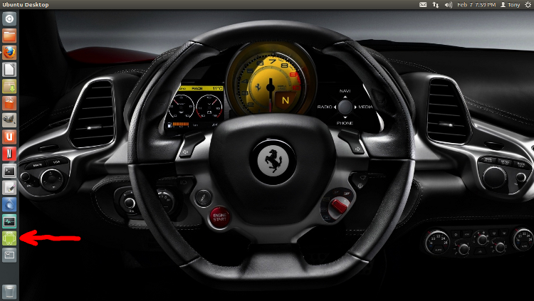

  • Open dash and drag the mount android device app to unity launcher.

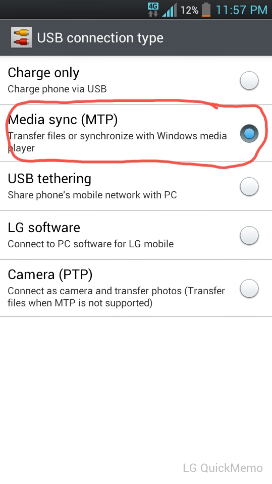

  • Now on your phone go to settings/pc connection/usb connection type/select mtp
  • Plug phone to pc and ensure mtp is on
  • Right click on unity launcher app and select mount android device and wait for notification on the upper right hand side of your screen.

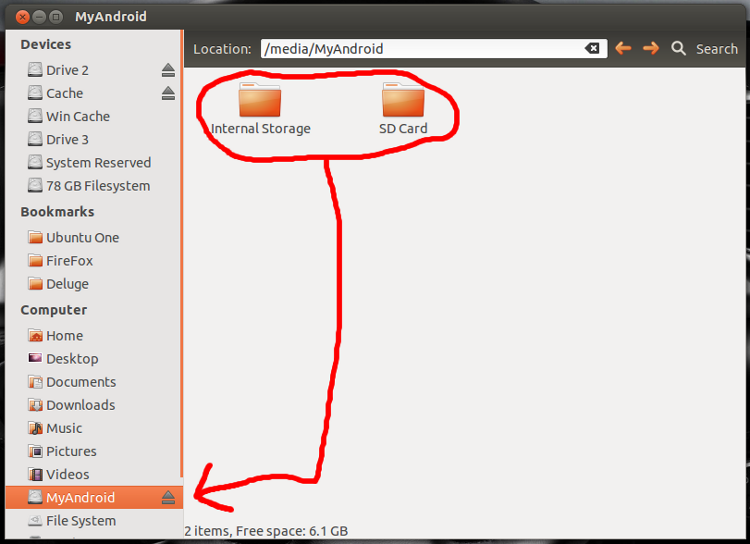

  • Open nautilus and click on MyAndroid... now your in.

-- The unity launcher app does not open like an app. It is only a mount point for android devices.
  • Now on your phone go to settings/pc connection/usb connection type/select media sync
  • Plug phone to pc and ensure media sync is on
