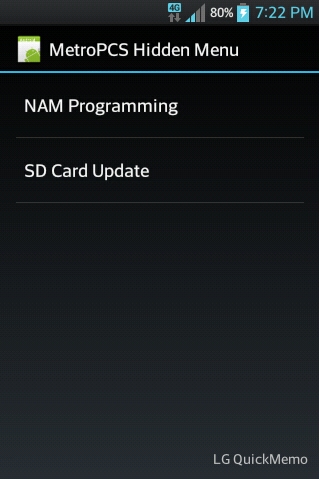

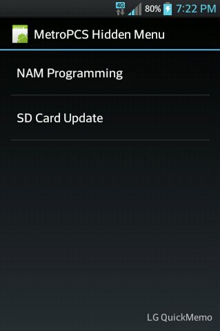

Why is it I can't get the ##626 menu everyone else seems to get. I only get below pic. I have to use 3845#*770# "no msl/spc needed" to get to the hidden menu. And some settings don't work like :set test environment: in EFC test. Also lgservicemenu won't accept my MSL, but ##626 will, it appears as below picture, how does that happen? I'm on stock rooted.
