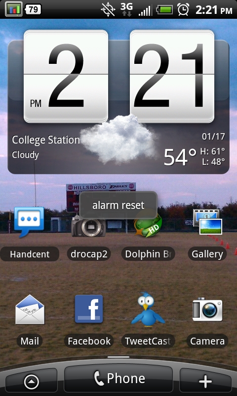

So i recently decided to flash a theme, and proceeded to do so.
I downloaded, moved it to my sd card, flashed into recovery, flashed the zip file, installed and the theme looked great....
Until i had this small rectangle box popping up in the middle of my screen that reads "alarm reset". I couldn't fathom what this could have been, so i immediately went and flashed back to the nandroid backup that i had made right before installing the theme. I figured this would fix my issue... but no. its still there.
It will pop up, then after a few seconds go away... then come back, and so forth....
I have since noticed that my phone will not go to sleep. If i want the screen to turn off, i have to lock it manually with the power button.
Dont know if it matters or not... but this is the theme i tired to install
http://forum.xda-developers.com/showthread.php?t=768848
If anyone could help me try and get this fixed, i would really appreciate the help...
Here is a screen shot with the alarm reset box
I searched around for a bit and only found people asking about this, but couldn't not find any real answers. So, let's try this:

I was running into the same thing. It seems to have been caused when I updated programs earlier today. The same day as your original post.
I checked for updates again a few moments ago and there were 2. Google goggles and another.
After these two updates, the 10 second spaced "alarm reset" message no longer appeared.
Causal relationship? Seems like it.

guys... I want to thank you for responding so quickly...
For some reason my problem has been fixed....
akazabam, I did everything you told me to, and i even got as far as about to post the results on here, and i realized that it has stopped what it was doing...
For whatever reason it was... this was the code that it was giving when the alarm reset box was popping up
01-18 07:19:58.018 D/cg ( 888): BootReceiver.java:34 app/alarm/rotatelogs/rotate

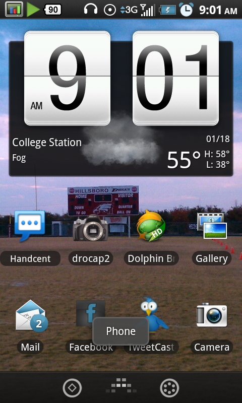

Ok... so i went ahead and put the theme back on and everything is fine...except for when I try to pull up the phone screen to dial a number the only response I get is a small grey box at the bottom of the screen that says "phone"
I like this theme but I kinda need the phone option...lol.
Any ideas?
It must have been related to an app update. A theme wouldn't have done that. Unfortunately, that one log entry isn't enough information. I guess it's a good thing it stopped.
What exactly do you mean a small grey box? Can you open the phone from the app drawer?
Yeah im positive it was because of an app update. Just a coincidence that it happened when i flashed the theme.
I went ahead and went back (again) with my nandroid backup, because I could not access the phone option, and to answer your question about the app drawer, no I could not. The Icon wasn't even there. Here is a picture of the "grey box"
That looks like stock (aside from the kernel). Did you flash a deodexed ROM at any point. You need to do that before trying to flash a theme like that. If you didn't, I'd be surprised the system booted up at all after flashing a theme. Pretty much any custom ROM will do.
At one point when i first started messing with the whole root process.. i flashed cyanogen, but i didn't like the fact that i lost everything, and had not realized what titanium would do, so i went back to my original nandroid backup.
So, i guess this obviously would be the root of my problem... Im backing up all my data now, and im going to flash a custom rom....
Any suggestions on which rom I should flash? whats your personal favorite?
I use mikfroyo, as it has some optimizations that make it load and run a little faster. If you use that one one, though, take note that while the mattedblues theme does support that ROM, it's still on 4.3. Mikfroyo is up to 4.4, now. Presumably, it will get an update, but you can still with 4.3 for assured compatibility. Also, make sure you use the Mikfroyo specific version of Mattedblues if you want that theme, still. Myn's Warm is also a good ROM. You can use the standard version of the theme if you like. Either way, see how you like the default theme for whatever ROM you flash. Make a nandroid backup of the ROM the way it is after flashing before flashing the theme, no matter what you decide.
