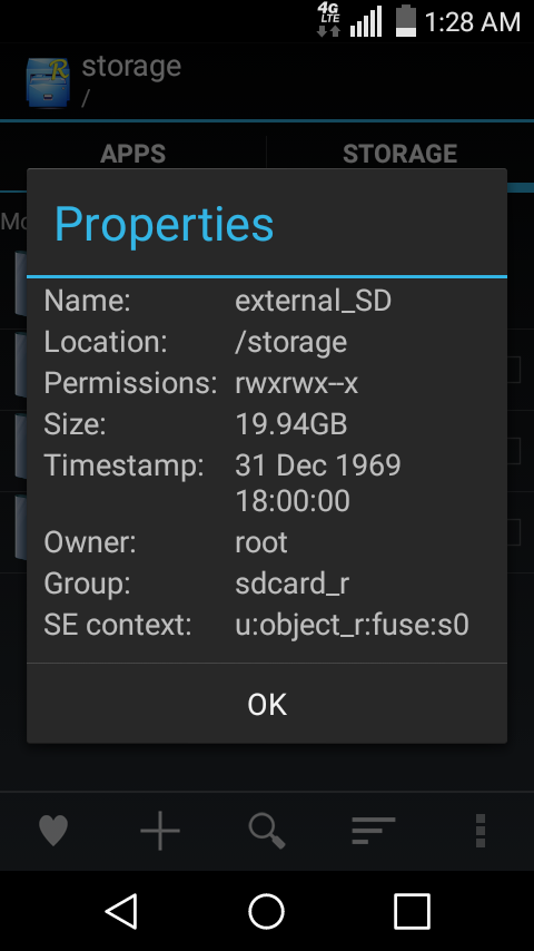

How strange.. My sd card that i cant backup to is a SanDisk Ultra PLUS 32GB micro SDHC. I have a micro SD pq1 2GB card out of my old rooted Optimus Elite or Zte Awe that works fine. I was able to copy move delete files and Erase Sd. On the one im having issues with, i cant even Erase Sd. Im going to plug them both into my pc and format the 32gb to the same as the working 2gb. Hopefully that fixes my issues.
Stranger.. I took these screenshots of the properties of the 2 sd cards. The working sd card has an accurate timestamp whereas the one that doent work has a timestamp from 12/31/1969. Also, i cant alter the contents of the non working 32 gb sd card in any way on any other device. (lg optimus elite- jelly bean cm10, zte awe kitkat cm11). I also cant Erase Sd on any other device with the 32 gb sd. This leads me to believe any of these scenarios:

Yep sounds like your SD Card is either corrupted or needs to be formatted. Hope you have luck getting it to work!

Im almost 100% my sd catd is damaged. On my pc, it says it is write-protected. Ive tried various programs and methods to remove write protection and format it. No dice. I read that micro sd's and flash drives will often state they are write protected when damaged. Which could be possible in my situation. Ill be purchasing a new one tomorrow.
Your card may not be damaged. When i last had a problem like this I opened up the SD Card adapter and found out that it was broken and had dirt in it. When i used another it worked. Did you try another adapter?
Yes. I tried a single adapter and a 32 in 1. I also cant alter this sd on any phone from jb to lollipop. Even through twrp.

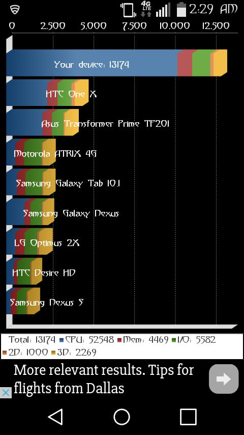

This phone is so amazing!! So happy i got it working. If this looks dangerous to you guys let me know.
This still on stock I'm going to assume. While benchmarks don't mean much compared to real-world usage, that's a decent score. Compared to CM which only gave me about half this.
Just shows there is a lot of optimization needed yet. Seeing as my dual core ZTE Awe could score 16k+, there is PLENTY of untapped potential just waiting for us under the hood
Yea im still on stock. Well downgraded with root. I used 3C toolbox and turned on all four cores. Games run super smooth. Also used RomToolbox Pro to change my boot anim. Gotta say i ABSOLUTELY love this phone now!!
