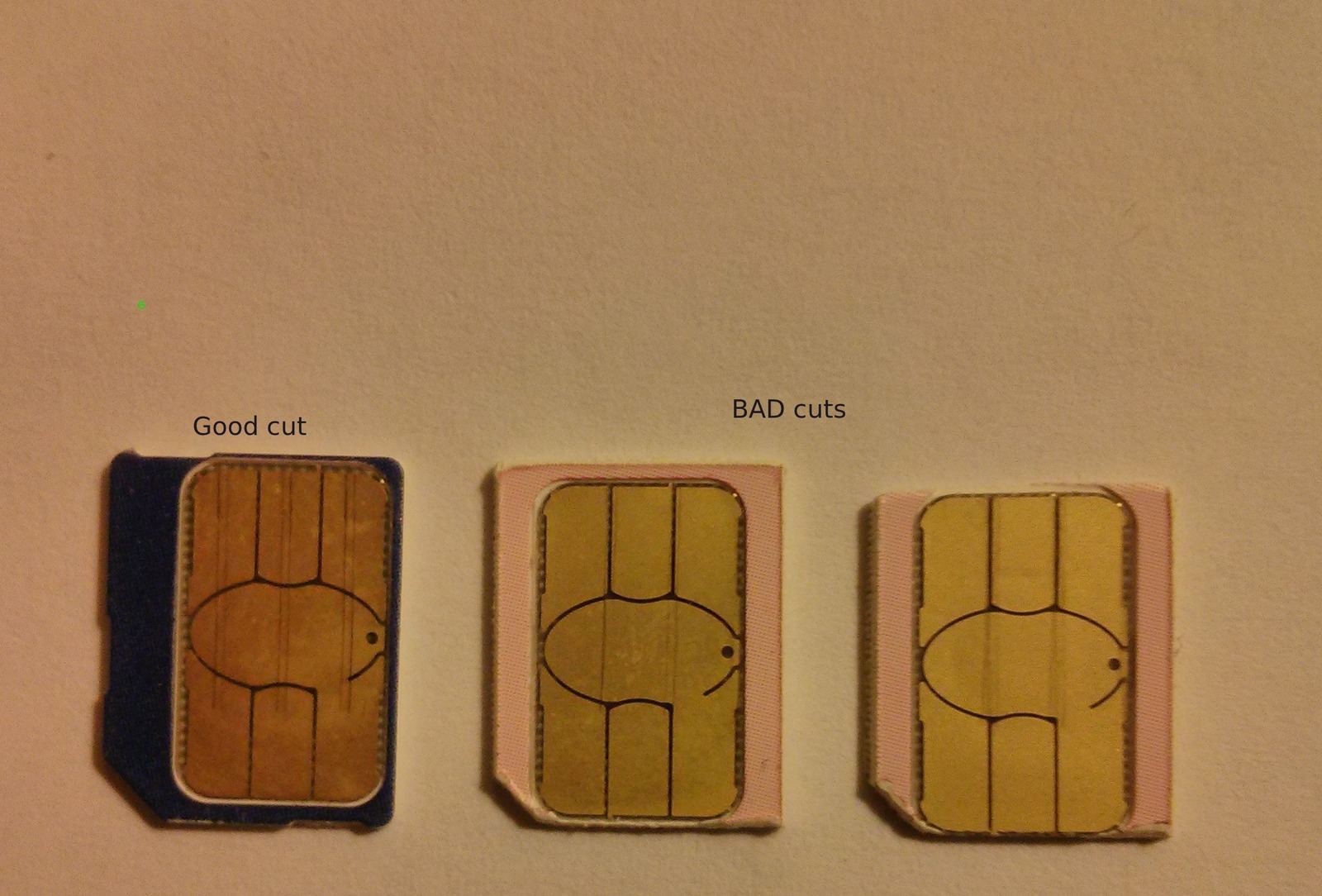

he says no sim card is displayed, I think that means the contact area of the sim is not making correct contact in the phone.
You could try trimming the sim card and wiggling it around in the tray while closing it.
See if there is any obvious mismatches in how it sits in the tray compared to the att sim.
Thank you. After a 62-mile (one way) trip to a phone store complex, the T-Mobile salesman who didn't know much referred me two doors away to a Boost Mobile store, where the young and very competent technician was able to show me that both the T-Mobile micro-SIMs supplied by Net10 were defective due to previously being mis-cut from the enclosed standard SIM. A jpg image is attached; good SIM on left, bad SIMs on right.
It's easy to see the marks where electrical contacts are made on the cards. The working card on the left has the contacts placed evenly in the centers of the three areas. The two defective Net10 T-Mobile SIMS on the right have the contact marks misaligned, causing their failures.
