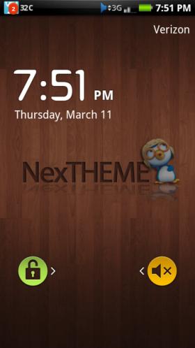

This ROM is very snappy and runs super cool. It would be perfect if we could get a transparent lockscreen like this one? What do you guys think?
