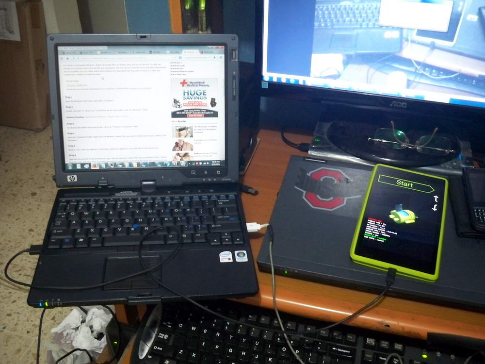

yes, it is connected, and it fastboot

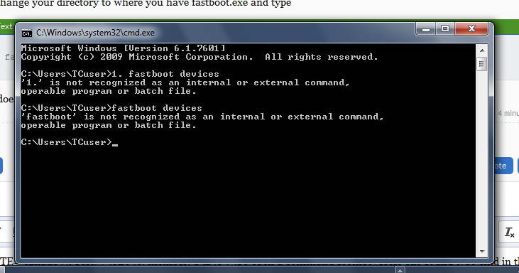

So open a command prompt (press ctrl-R and type cmd in the run box)
Then change your directory to where you have fastboot.exe and type

What does it say?

anyway i guess i understand you wanted me to open the black windows where funny things are writen right?
i just click on start and click on "Run...", then y type cmd in the empty space of the dialog box... and then the black box came up
i write it there what you mentioned
and this is what i got

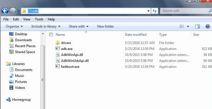

i think you said fastboot was located in c:\adb so type
Code:
cd c:\adb
press enter and then try the fastboot devices command.

this is what i have
is that fastboot.exe and adb.exe what you are talking about?

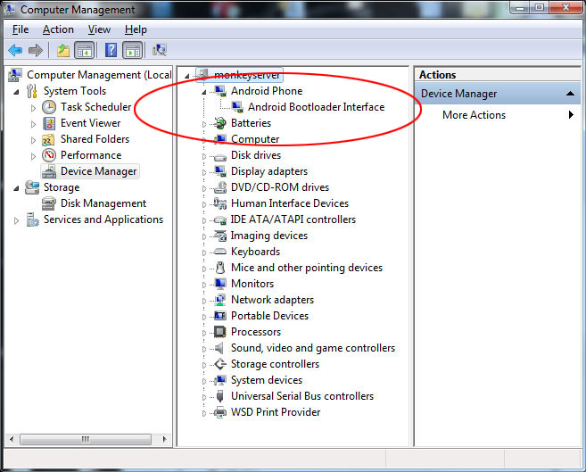

Yep, that's them ... and just for argument's sake, could you show me if the device is listed in device manager? Open start then right click on 'computer' and select 'manage'. Under System tools you should see Device Manager. Click on that and look for Android in the list on the right.
Okay, so it's not only NOT there,it doesn't even look like the device is recognized (I think you said that already). It should look like this
Try a different cable, a different USB port on your laptop or a different PC altogether. Until you can get the device recognized, there's not much that can be done.
i dont know what is going on... but i guess this crap (the nexus 7 2013 ) works that way, i have almost 3 years with this tablet and that entry in device manager is not even in my main computer (which is the one i mainly used when moving files), i also checked in other 3 computers with which i previously have attached the nexus 7 and succesfully interact with them... and there is any trace of any android device in none of those computer
this could sound stupid but
are you sure that android devices has a "LIVE" usb port when out of the OS? in a locked and no usb dbug mode enabled device?
well...
this thing is dead
and i could think that maybe that is they problem why it is in bootloop.. but no because it has been that way always, she (the nexus) never has been recognized by any of my computer in fastboot mode
